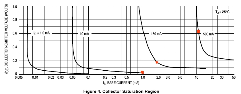

DC power loss in BJT and MOSFET. To compare I will use MPS2222 and a BS170.
The BS170 MOSFET has a D-S resistance of about 1.25 ohms when “closed”, Vgs=7 volts. Here is the ON curves for the MPS2222 transistor. The red dots are for the MOSFET.
The MOSFET with 1.25 ohms on resistance will have
0.625 volts loss at 500mA
0.187 volts loss at 150mA
0.0125volts loss at 10mA
The BJT will have 0.2 volts loss at 500mA with a base current of 50mA. The base current will have to be under 12mA for the BJT to have more DC loss than the MOSFET.
