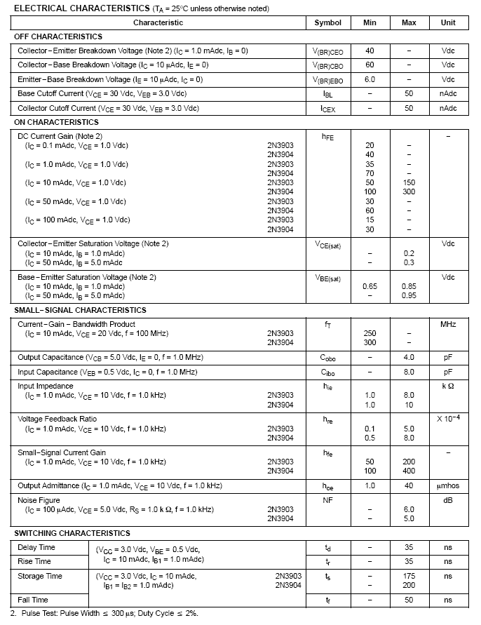

I want to learn more about using bjt as electronics switch. Usually I will connect the load to the collector, the emitter to GND and the signal to the base (for NPN). But I don't know which NPN BJT to be used, I always use different transistors to try, until I got it. This is because I don't know how to read the datasheet.
Last time, i use a tip41 to switch a relay with 5v, i feel i was so lucky for that.
If i want to use a 2N3904 as a switch, with 5V, what should the load resistance be? Can anyone teach me to read the datasheet? Let's start with 2N3904.

the first thing to decide is how much you expect it to switch , (say if 80ma ) , then select a trans that can pass more then that current, here your 3904 can handle 100ma (200ma Max) , now look at datasheet to check what will be the hfe at that current because it will decide the base current, you can see that it is 30 , so design the base ckt as per this , now at 100ma ,and max vce(sat) is 0.3v , so the max continous power dissipation u expect 30mW , require a heatsink ? u deside ?. remember during switching , before reaching saturation the transistor is going through the active region where the power dissipation will be very high . so go for max switching speed(ref: switching char: ), and minimum switching

The hFE rating isn't used for a transistor acting as a saturated switch. Its saturation rating of max 0.3V is with a collector current of only 50mA and might be double at 100mA, and with a base current of 1/10th the collector current.

Which part of the datasheet mention that it is 100mA and 200mA max? Is it at 'ON characteristics'---(IC = 100 mAdc, VCE = 1.0 Vdc) ? I don't know the way to read the datasheet... sorry about that..

Maximum ratings -> collector current continous ( remember it should be read along with the max device temperature)

The Thermal Characteristics spec's on the datasheet for a little 2N3904 transistor has a max Total Device Dissipation of 625mW when the ambient air is at 25 degrees C and it says to derate at 5mW/degree C when the ambient air is warmer.
Its absolute max continuous current is 200mA. If you want it to survive then don't use it to turn on a motor that draws more when starting. The resistance of a motor indicates how much current it will draw when starting.
the issue of "what's high power or not" is dependent on the package's ability to dissipate heat. You didn't include the thermal characteristics but fromthe fairchild 2n3904 datasheet, the to92 package has a thermal resistance (junction to ambient) of 200 C/W. That means each watt of dissipation will raise the device temperature by 200 C. So, you just multiply this times your computed dissipation (Vcesat * Ic) and add the ambient temperature and you have the device's temperature. example: if you are dissipating 100 mW, your temperature will be 20C higher than the ambient temp. At 25C, that would make it 45C. nothing to worry about. In fact, with a low Vcesat like the the 2n3904 has, you will probably blow the transistor long before it needs a heat sink.
