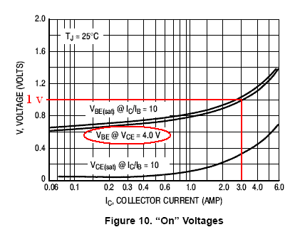

but there is another graph that i think carry the same information:
the Vbe when Ic is 3A, Vce is 4V is 1V. right? (the red one is my edition).
So, to turn the load on at 3A for tip41, the base current has to be 0.3A, and 1V, right?

Each spec for the same kind of a transistor is a range of numbers, some of the transistors will be very good and others not very good.
The saturation voltage of a transistor is important because if it is high then the transistor gets hot and needs a bigger and more expensive heatsink to survive.
For a TIP41 transistor with 6A of collector current and 600mA of base current, a "good" transistor has a collector-emitter saturation voltage of 450mV or less and therefore needs just a small heatsink, and the "worst" one has 1.5V for its saturation voltage and will melt without a pretty big heatsink.
EDIT: Max saturation voltage corrected

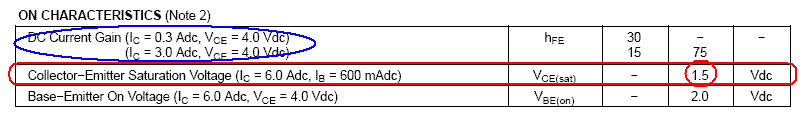

For a TIP41 transistor with 6A of collector current and 600mA of base current, a "good" transistor has a collector-emitter saturation voltage of 450mV or less and therefore needs just a small heatsink, and the "worst" one has 2.0V for its saturation voltage and will melt without a pretty big heatsink.
But the datasheet won't show the 'good', then how are we going to know it? As mentioned before, the datasheet only shows the 'worst', but I see that the collector-emitter saturation voltage is only 1.5V but not 2.0V (red circled of the attachment). I'm not sure whether my reading skill in datasheet is correct or not, please correct me if I'm wrong.
And, note the blue circled part, what is DC current gain? The Collector-Emitter voltage I can see is 4V. I don't understand this part.

It doesn't matter how good a transistor saturates. It is nice to know the typical saturation voltage as shown with a curve on a chart so you can calculate how well a circuit will work. The minimum ratings (worst) are given so that you can design the circuit to always work with any transistor of that part number.
With a 6A collector current and a 600mA base current, the max c-e saturation voltage is 1.5V. I was wrong before when I said 2V.
The current gain changes a little when the collector-emitter voltage is changed, so they say its range with Vce= 4.0V. The current gain with a collector current of 300mA is guaranteed to be a minimum of 30. The current gain with a collector current of 3A is somewhere from 15 to 75. They can't make them exactly the same, some are better than others.

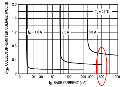

From the attachment, If the Ib is 500mA, how much is the Ic? 2.5A or 5A? Why there are two at the same base current?
The Ic is determined by the load's resistance and the power supply voltage. This graph shows the transistor being turned on hard, with different Ic and different Ib.
They show typical values of saturation voltages, a low saturation voltage when the collector current is low, and a higher saturation voltage when the collector current is higher.

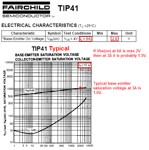

tip41-png.9459
from the graph above, it shows that the collector current (max) is 6A, so the base current should be 600mA, and the voltage is 2V. but as i know, the microcontroller's output is always 5V right?
micros o/p is either 5 or 0v , and we add a small resistor between the o/p pin and the base of transistor .
Look at the datasheet for your microcontroller. Its max output current is about only 25mA. You need another transistor to drive 600mA into the power transistor. The base current of the new transistor will be about 20mA or less and is limited with a series resistor.
The output voltage of the microcontroller is 5V without any current, and drops when loaded. It might be only 2.5V with a 25mA load.
