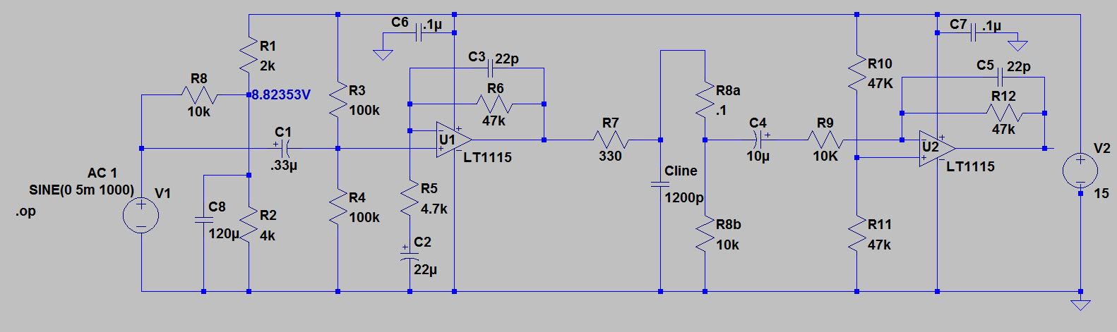

Since I have decided to go with a regulated supply, I hope the simple voltage divider at the MIC will do the job. It supplies 8.2V to bias the MIC. What do you think?
The FR curve looks very good. Straight as a string from 10 to 40K Hz. Only need 20 to 20K, but what the heck. It looks good.
I finally figured out how to get polarized caps on the schematic. Will you check the cap polarity to be sure I got it right?
Is the gain spread between the stages where it should be?
Any improvements you can think of?
I really thank you for all your help with this. I hope it has not been too boring for you.

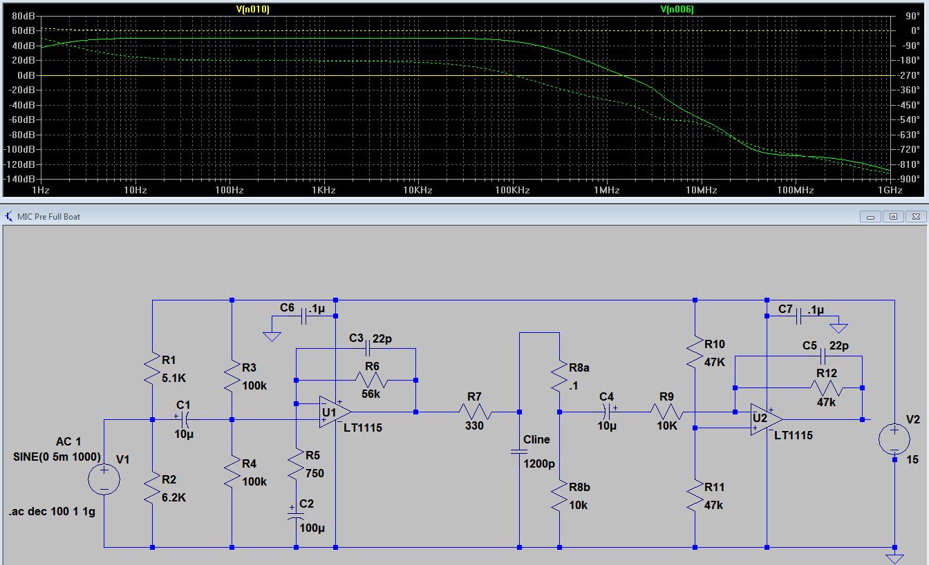

Below is a pic and I have also included the LTS file if you want to give it a try.
Thank you.
You do not understand that an electret mic has a fairly high impedance and the very low values for your R1 and R2 in the divider are killing its output level.
Make a divider to provide 9V. Make the current in the divider be 5 times the current in the mic. The mic current is about 0.5mA so make the divider current be 2.5mA. Filter the divider's 9V with a capacitor.
Then power the mic from the divider through a 10k resistor that will not load down its level.
You forgot to calculate a reasonable value for C1 because its value is way too high and it will take "all day" to charge.
C1 feeds R3 and R4 in parallel. Audio goes down to 20hz but 10uF into 50k ohms goes down to 0.32Hz earthquake frequencies. Use 330nF (0.33uF) for good bass response.
You also forgot to calculate a reasonable value for C2 because it also takes "all day" to charge and passes earthquake frequencies down to 2Hz. Use 22uF.
The circuit has such a high gain that it will pickup background sounds from all over your city.

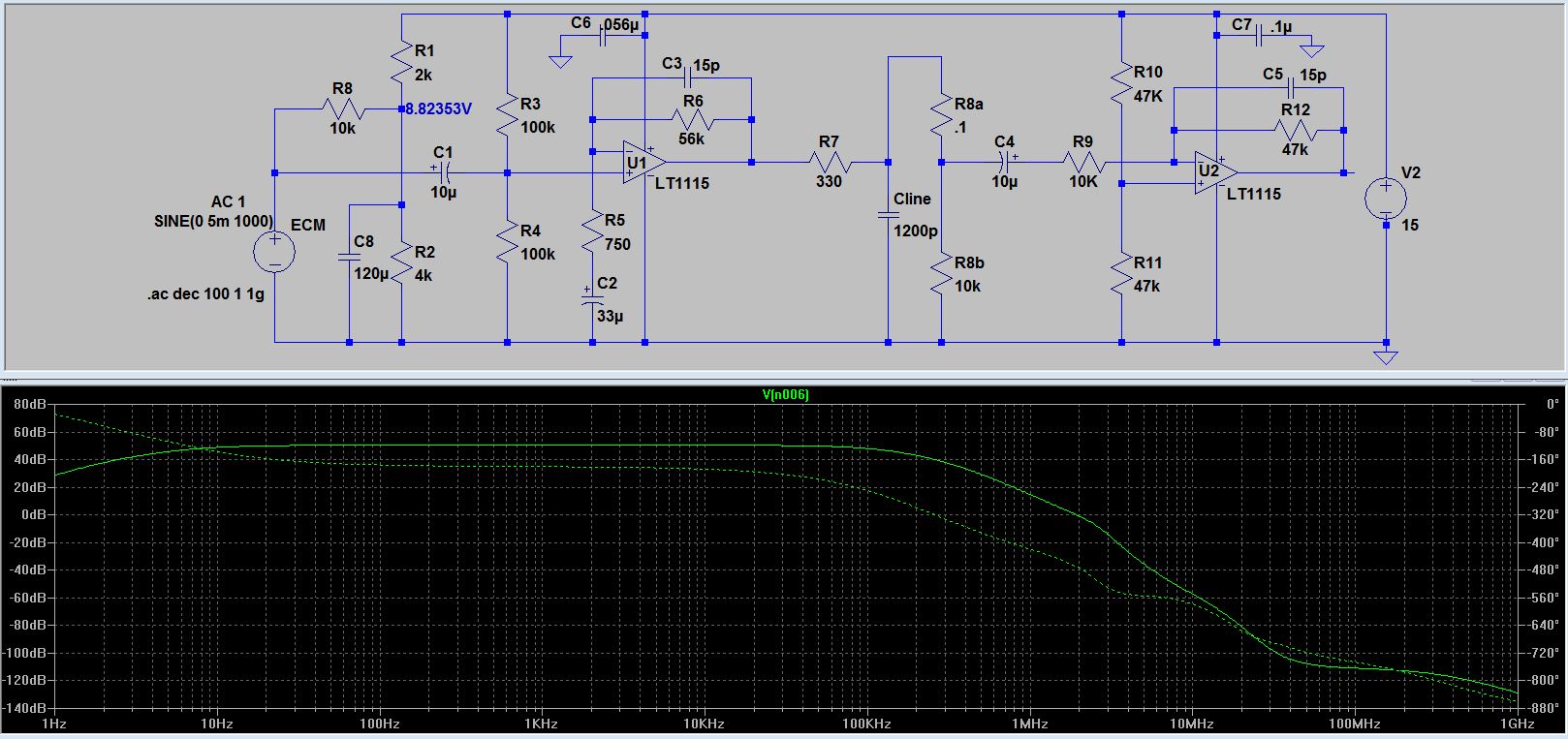

Is this better? (see the image)
Any suggestions for improvement?
All to the left of the cable capacitance will be in a mic wand body that will be able to swap capsules. It will be used for hobby speaker measurement and crossover design. The output will go to a test box and then to line in on a USB out board sound card feeding a laptop.
The OPAs will be LM833N and the pre will be fed from a regulated supply through xlr connectors.
I am concerned about the gain structure. It needs to be high enough to put 0 dB to line in but not so high as to overload line in. That is why there is a pot (R8a and b) to the second amp that will be in a test box near the computer. Speaker measurement will be at about 90 dB SPL. There will not be any high level distortion measurements.
I am also concerned about the general resistor choices and their contribution to noise.
Any suggestions and improvements will be greatly appreciated.

It seems that you do not know the simple formula to calculate the value of a coupling capacitor. A coupling capacitor feeds a resistance which causes a cutoff frequency (low frequencies are reduced). Our hearing goes down to 20Hz so a single coupling capacitor can have a cutoff frequency of 20Hz. If there are two coupling capacitors then each one reduces low frequencies so each capacitor should be calculated for 10Hz. See my attachment.
You increased the value of R5 so the new value of C2 should be 3.3uF.
I am glad to see that you corrected the mic biasing and reduced the total gain.

I'm not sure I would change the gain. I think AG missed that R8a and R8b were just used in spice to make a pot. Since some sound card use up to 780 mv and others up to 1.5 volts I'm not sure I would change it. You can always turn the volume down, but if you don't have enough.:(
The big caps don't really hurt anything that I can think of. It is just as AG said it will take about 5 seconds after power on to get sound out. with the smaller ones maybe 1.5 - 2 seconds. Maybe somewhere in the middle would work if space becomes a problem. With 9 volts as the supply I would leave the little filter and the 5K resistor feeding the mic.

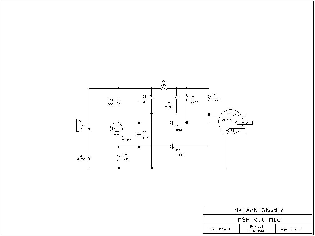

Now that we are on another page, lets examine the Naint schematic.
M1 is an ECM with built in FET. That is followed by a FET preamp with balanced output and it needs phantom power. That is followed by an amp/buffer/level-control/phantom-power circuit that converts the balanced input to an unbalanced output for a sound card.
I am sorry I do not know the proper names for these circuits. But that is what I call them in my mind.

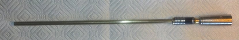

Naint uses these for close up drum MICs and warrants them against stick strikes! But those are too short for measurements. Reflections, you know. What I intended is this
with the pre inside the XLR to RCA jack and the amp/buffer/level-control/phantom-power in another box by the computer. This design allows you to swap out the ECM wands (different lengths) as needed. Neat!
Connectors will be XLR from the MIC pre to the amp/buffer/level-control/phantom-power circuit.
As far as gain is concerned his MICs apparently have sufficient headroom to handle close MIC'ed drums. I will rely on you as to what is needed for speaker measurement.
Is this doable?

Here is the latest version.
Please look it over and see if anything at all needs to be changed for better results. Remember I am using a prepackaged power supply and taking +15 from it. If it is good to go, I will build it.
Thank you for this design ronv. It is your design after all.
The only thing I can see is R8 could be smaller now, say 5.1k and the polarity of C4 should be reversed.
I will change C4 to film.
When I change the vol pot R8 to 5K I take a hit on bottom end FR. Not much, but a hit. Should I reduce it to 5K?
Oops, 2 R8's. I was speaking of the one in your schematic that powers the mic. :o
Oops, my bad. I have renumbered all.
I know the voltage source as the MIC is not accurate but see the voltages on a sweep at C2. Which way should the polarity be? Geez I don't want to back up two electrolytics here for as a non-polar.
I found I can fit a 240u at C1 for the filter. Is that good?
BTW, it looks like you got to about 8V for the MIC.
No problem. The way it is the voltage at the mic will always be higher than the 2 100k resistors. So it's ok the way it is.
240 is ok if it fits.
