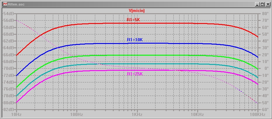

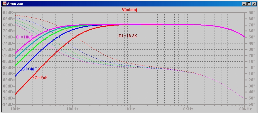

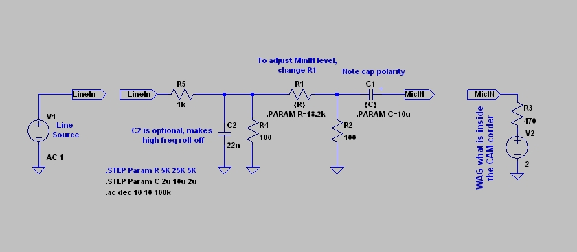

Sounds to me that you need a whole lot of attenuation as well as dc blocking. Your input level is only 0.38mV, while things that produce "line level" usually produce about 1V, so you need an attenuator which drops the level by 0.00038/1 or -68db.
As for blocking the DC, the cap follows the attenuator; Here is my guess at what you need. Note the attenuation as a function of R1, the low freq roll-off as a function of C1, and the optional high-freq roll-off.

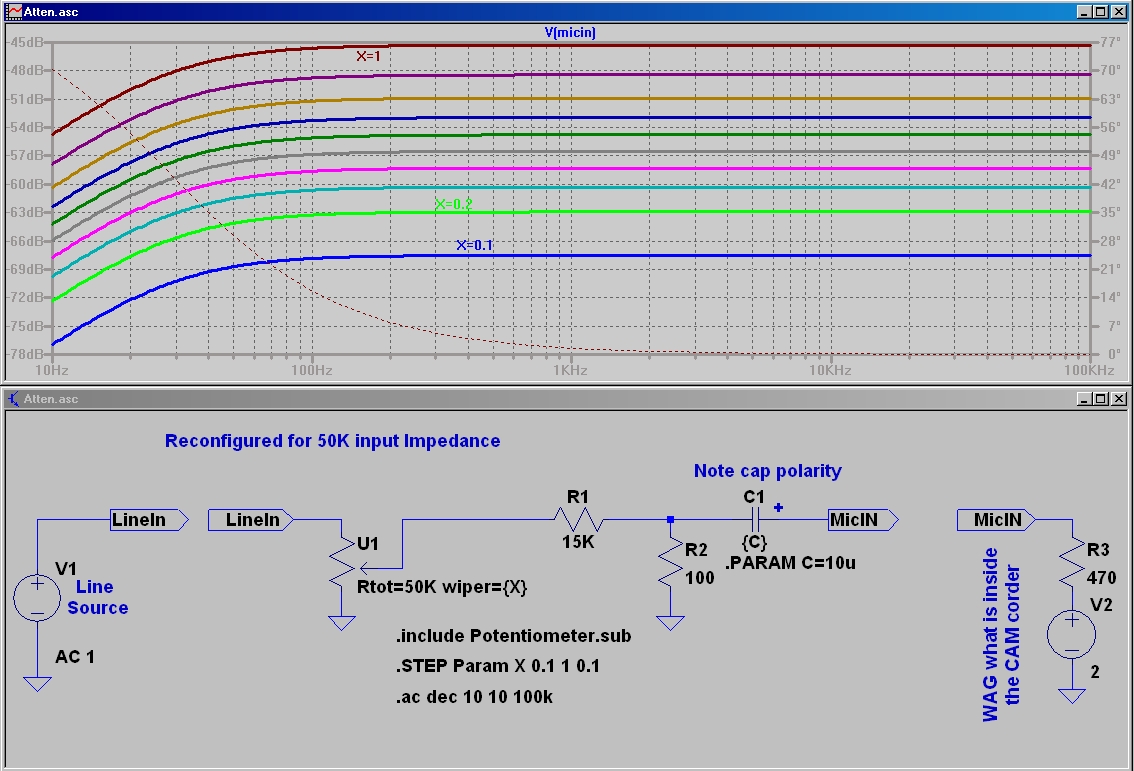

Impedance Matching
Most 'line level' signals are meant to drive an input with an approximate impedance of 50K. I would suggest increasing the resistors on the input of the circuit to something closer to 50K to increase sound quality. A variable resistor in the last attenuation stage would also help with volume adjustment.
Good point. Here is a revised circuit that has an input impedance of 50K, has a trim pot for adjusting level over a 30db range, and keeps the low-freq corner more or less in the same place as the pot is adjusted.

Are you sure the ceramic was 1 to 10uF, or where you using one which was in nF?
You need ~10uF, which might be marked "106".
Hmmm...it's simply marked 1. Radio Shack part # 272-0801
It's a 100 variety pack. I also tried 10. There are no other markings beside what looks like a dot of black tar on top of each one.
I'd be surprised if the largest capacitor in that variety pack is 0.1uF (100nF or 100000pf or 104), a factor of 100 too small for your application. At that, it should have passed some audio, albeit very tinny sounding because it would tend to pass high frequencies much more than low freq.

It worked like a charm! I ended up going with 30K and 100. I only tested with my mp3 player so far but it sounded great. I turned it all the way up (a Sansa clip) and it didn't distort. It was actually .2db under 0 on a pretty loud song. I'm thinking with my mixer I might even need to ride my faders a touch low.
