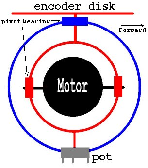

an accelerometer will measure the acceleration of gravity as well as other movements. so if you take one and rotate it 360 degrees on one of its measurement axises, you will see that it goes from 1G (horizontal) to 0G (vertcal) to -1G (horiz, inverted) to 0G back to 1G. a 30 degree angle will give a reading of sin(30) or .5G. you will need to filter out vibrations and such.
I meant to use the pot as a pivot for the gyro gimbal. You could use an encoder disk on it instead. You could use a small motor with a flywheel that is heavy enough to make it stable. Easy to make. The illustration is a top view.
what kind of accuracy is needed? the encoder disk will need to be constructed with that in mond.
