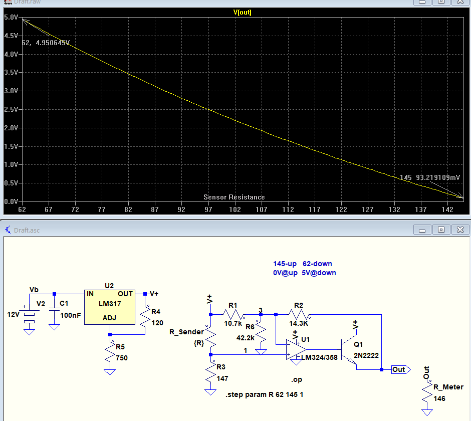

Hello all,
I am trying to get a boat trim sensor and meter configured, this is a 12 V DC system. The sender that attaches to the trim unit is a potientometer, and shows 145 ohms at “full up travel”, and 62 ohms at full down. The meter requires 0v at full up and 8.5 volts at full down.
I created a voltage divider with a 500 ohm pot for adjusting the range, and I get the best results at about 122 ohms, but I am only getting about 60% of the indication on the trim meter (basically a voltmeter).
Somehow I need to increase the scaling, as I am stuck with the sender on the pot. Not sure how to proceed. TIA.

Below is the LTspice simulation of a circuit that should do what you want.
It uses a common, single-supply op amp with a transistor output buffer to generate the 5V to 0V for a sensor resistance variation (Rsender) of 62Ω to 145Ω (yellow trace), to drive the meter (simulated by R_Meter).
I added the common LM317 voltage regulator to generate a constant 9V for the circuit which minimizes any change in the meter output voltage due to variation in the battery voltage.
If you have any problem buying the parts, let us know, as substitutes should be available.
Thank you, this is awesome, and will be fairly easy for me to construct with a dip socket device and protoboard. Does the lm317 need much of a heat sink?
The circuit current is low, so the LM317 will be dissipating no more than about a half watt, which occurs at the maximum battery charging voltage.
If you use the TO-220 case version of the LM317, the case itself will dissipate that amount of heat readily without overheating.

On papabravo’s question about calculating values, since I do not know, which resistor value would control scaling and which would control min or max values if I do need to tweak it?
So just let us know if you have any problems after you build the circuit and we should be able to resolve those. :)
Thank you, I am Chip hunting now. Will report back certainly if I have issues and also if it is successful, thank you all again, It’s really great being able to get this level of help. Gotta love the Internet!
Unfortunately, that relatively simple circuit has an interaction between the scaling and the offset resistors so changing one resistor tends to change both.
If offset or gain needs to be changed, their values would need to be recalculated.
Well, it never hurts to ask, not surprised though. Thanks
If you want to add some adjustability you could change R6 to a 50kΩ pot and R2 to a 20kΩ pot.
R6 would mostly adjust the offset and R2 the gain, but there will be some interaction between the two.
If you use those pots, set them to near the values shown on the schematic before installing them.
To use them as adjustable resistors, connect the wiper contact to one end of the pot resistance element.
That way, even if the wiper element loses contact, you still have continuity through the resistance element.
