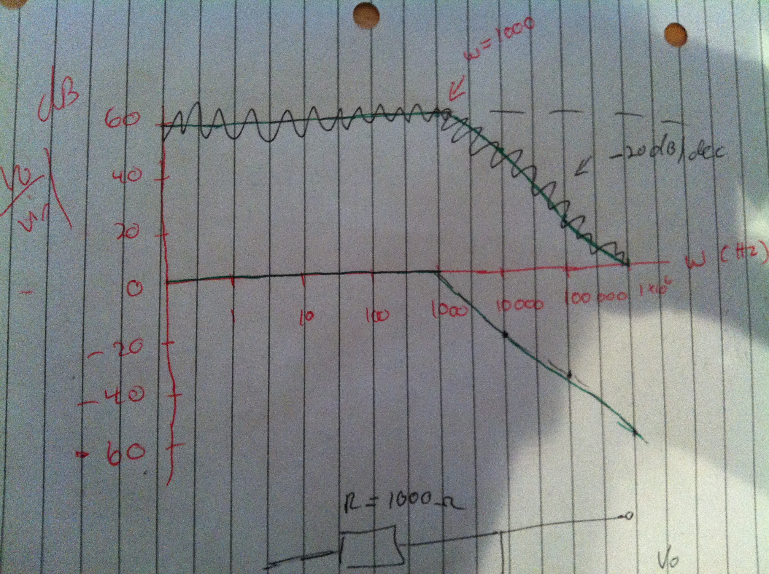

You were going pretty good there, with your low pass example. You came up with:
Hs=1/(sRC+1)
and then you divided top and bottom by RC:
Hs=(1/RC)/(s+1/RC)
and you reasoned that you have a pole at 1/RC (of course you know this is really -1/RC). You did very well there.
But now you KEPT that form to figure out the gain, so you of course got the gain 1/RC.
BUT, in the previous discussion, we had to get the equation into the form with the factors (s*tau+1) in order to find the gain K. For some reason you skipped this step and that's how you got the gain of 1/RC, which of course isnt right.
Getting back into the s*tau+1 factors form, we have again:
Hs=1/(sRC+1)
with tau=RC. Now the only thing left in the numerator is the '1', so the gain K is equal to 1.
So try to remember which form is which, and that you need the transfer function in the s*tau+1 factors form to get the gain to stand alone in the numerator.
Haha, yeah I actually don't know why I did that now that you mention it. I forgot that the only reason we change the form is to get the value of w for the pole..
We have a pole at w=1000Hz (so -20dB/dec from that point), before that we have a constant gain of 1 since it was already in the correct form and K = 1. 20log(1) = 0. so actually it would be the same plot, olly shifted dhown from 60dB to 0dB as shown on the attached picture.
You have to remember that I don't really have much experience with using these plots, so the values don't mean too much to me...

It appears that you were trying to do the first one (C=1nf, R1=100k, R2=10k) so we'll do that one first. You'll want to note that the zero and the pole cause opposite sign slopes, one +20db/decade and the other -20db/decade.
The transfer function Hs is:
Hs=(s*C*R1*R2+R2)/(s*C*R1*R2+R2+R1)
At zero frequency the gain K is equal to:
K=R2/(R1+R2)
and dividing numerator and denominator by C*R1*R2 we get:
Numerator: N=1/(C*R1)+s
Denominator: D=1/(C*R2)+1/(C*R1)+s
So we have constant gain:
K=1/11
and the numerator is:
N=s+10000
and the denominator is:
D=s+110000
Thus we have a zero at w=10k and a pole at w=110k, and constant gain -21db.
The two frequencies are 10k and 110k, so we start out at w=0 with the constant gain of -21db which is a straight horizontal line (like you have drawn) and at the frequency of 10k we have a zero so we get a slope of +20db/decade starting at 10k. This continues until we reach 110k and there we have another frequency of 110k which is a pole so we get a slope of -20db/decade starting at 110k, and this added to the previous slope means we again get a line with a slope of 0 which is a horizontal line.
So the plot looks like a horizontal line at -21db that goes from w=0 to w=10k, then slopes upward at +20db/decade, then at 110k it becomes a horizontal line again. Since the slope of the upward line is +20db/decade and it starts at -21db and goes from 10k to 110k, that means it goes upward about +22db and this means we end up at +1db, but the horizontal portion from there is around 0db because since the cap conducts much more than the 10k resistor at infinite frequency, the response is clearly 0db above w=110k. Note that since the distance from the 10k to 110k is really 1.1 decades, we would multiply 20db times 1.1 and get 22db as the rise so this would lead us to +1db rather than 0db. But the quick check with the cap and 10k resistor shows this to really be 0db. So we've corrected this a little by doing that.
Also note that when you get a pole after a zero it cancels out the slope of the zero because the pole has the exact opposite slope as the zero.
So the plot looks like this:
   0                 ------------------
 -21  -----------
      0        10k  110k              +inf

Did you take into account that the graph Eric's plot shows has the running variable of regular frequency f and not angular frequency w? Most of these calculations are done in terms of w not f, so we end up having to convert at some point for some real problems.
Hmm.. well when if I DONT divide by 1e^-8 then I get the following (when using the quadratic equation in the denominator):
H(s)=(1e-4*s)/(1e-8*s^2+3e-4*s+1)= (1e-4*s)/[(s+3819)(s+26180)]
But now when you change it into the appropriate form you will get a different constant since the numerator is still 1e-4s due to the fact that we never divided by 1e-8
so: K = 1e-4/(26180*3819)
but that can't be right... (am I missed something obvious?)

Yeah I completely understand! My weakest point is probably algebraic manipulations since I understand the concept and do actually know what I am trying to do, its just that sometimes I will be stuck for a while and not see the most obvious manipulation (its obvious when someone points it out hehe). But yeah Thanks for all your help anyway!
Okay, I think I figured the algebra out now...
when you use the quadratic formula you have to make sure you take into account the coefficient in the second order term as so:
(1e-8*s^2+3e-4*s+1) ≠ (s+26180)(s+3819)
(1e-8*s^2+3e-4*s+1) = (s+26180)(s+3819)*1e-8
Because even though when using the quadratic formula it takes into account all the coefficients, when writing the equation you still have to add in the coefficient in the s^2 term! (I never actually knew that...)
Thanks! ;)
I am happy to hear you figured everything out. You know that the more you know about math the easier this other stuff will be, so you might even want to take a refresher course in some math especially maybe precalculus. You'll be so familiar with these math concepts that you'll be able to concentrate more on the matters at hand much better and faster and wont have to keep stumbling over these little details. That way you can enjoy the electrical/electronic parts much more too.
