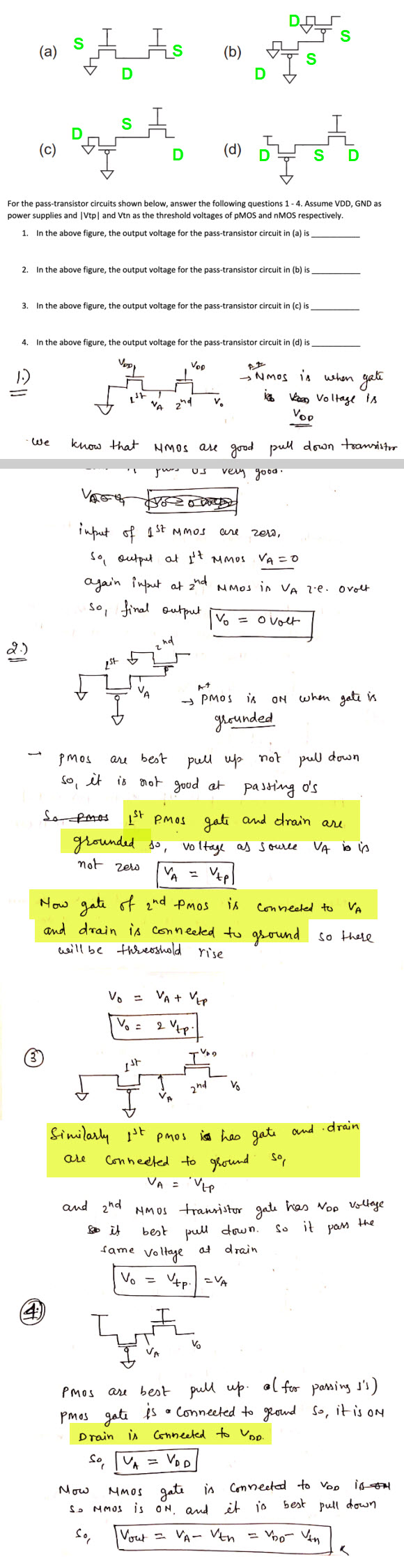

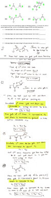

The capture below has been taken from the attachment titled "Pass_1, https://www.electro-tech-online.com...136257/?hash=853c71bf3277105a2fdd29712da93eef . The answers provided are correct but I don't understand the connections. I labelled the connections as "Drain" and "Source" myself. In the attachment they also use the same kind labelling and also on some other webpages I found the same scheme of labelling. think these circuits are classified as pass transistors. For example, look at image part "(d)" below. The drain of PMOS is at higher potential compared to the source, and the source of NMOS is at higher potential compared to the drain. I don't know how such circuits are working in reverse manner where drain and source terminals have been reversed. Does it have something to do with body terminal? Could you please help me?

As long as the gate-source voltage is correct, a MOSFET will conduct in either direction while "on".
That is used in some analog switching circuits and also occasional power control circuits.

Question 2. I will make two oblique comments. First of all, it is a mistake to say that the N-channel drain must be more positive than the N-channel source (and vice-versa for P-channel). There are perfectly valid circuits and circumstances in which the channel is reverse-biased. In most cases, this results in the body diode conducting but not always. Instead of saying, effectively, that the channel must be forward-biased, as if it were a rule or law, let us say that, if the channel is reverse-biased, the body diode will be forward-biased and so it may conduct even if the transistor is "turned off" via the gate terminal.
Second, the examples you cite are a test question. These don't all represent practical circtuits. Think of circuit D as a "trick question." Don't ask if it is a good circuit. The question isn't whether it makes sense in the real world. The question is, what will it do?
