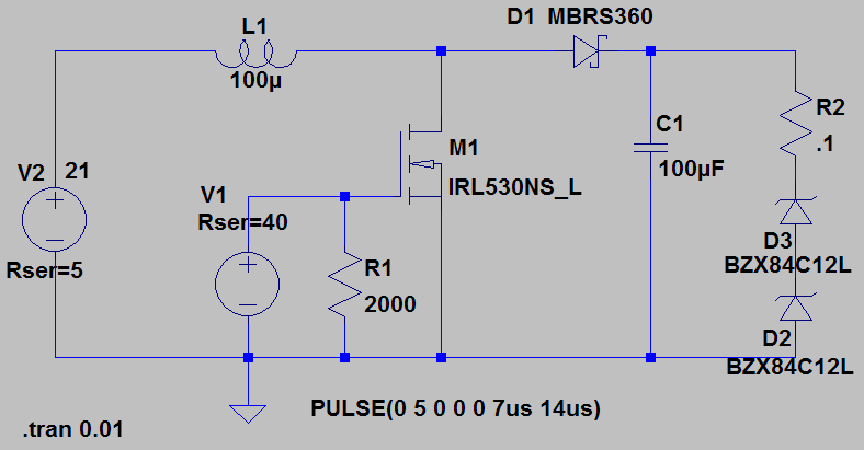

I got around to having a play in Switcher Cad.
For the solar panel I used a 21V source with a series resistance of 5Ω.
For the battery, 2 x 12V zeners and a 0.1Ω resistor.
I pulsed the gate with a voltage source at 70kHz with a series resistance of 40Ω. Plus 2k resistor to turn it off.
It seems to work, input is around 12V 1.8A and output is 26V 0.6A.
Anyone any comments or suggestions before I build this?
Is a BUZ71 suited to this? With a gate threshold of 3V I'm hoping it can be switched with the pic output.

If you notice the data sheet, the BUZ71 requires 10V to fully turn on and achieve its 0.1Ω rated "on" resistance. It's only conducting 1mA at the threshold voltage. You need a logic-level MOSFET if you want to drive it with 5V.
Ahh, hadn't looked at the datasheet, just saw the gate threshold in a table and assumed - must remember, it's dangerous to assume. Guess I'll order a few IRL540 unless anyone has any better suggestions?

as the mosfet is running at up to 14 V and the pic 5 V some duffer/driver whatever is a good idea TC1426/7 are quite good and cheap for this, I've been using a TL082/4 opamp
Just ordered some IRL540s and some TC1427s.

OK, if you want to make a 12->24v converter (which must require a SMPS) you may as well make it a MPPT to get the extra bit of power into the batteries.
The BUZ71 is way obsolete in terms of making high performance SMPS. There are many much better NFETs available. One of the good things about going 12v->24v boost is that you won't gain much from synchronous rectification so you can just use a schottky diode for the rect, which makes it a lot simpler.
To make it a MPPT boost circuit you need to regulate the switching to maintain the INPUT voltage, and keep that at about 17v. That will operate the solar panel at or near max power output. Then if you need the circuit to act as a battery charge controller you use a second system to shut it down when the battery is full, or keep it running and dump load when the battery is full.
You won't find many schematics for boost SMPS that regulate input voltage however. ;)
There's a couple of ways if you are using a PIC as controller;
1. make a fixed period ON pulse whenever the input rises above 17v, this will work fairly well in boost as the input voltage is constant and known, as is the input capacitance and the input current is constant
2. generate a PWM signal and monitor the input voltage and keep adjusting the PWM so that the input voltage remains at 17v (which has its own issues)
