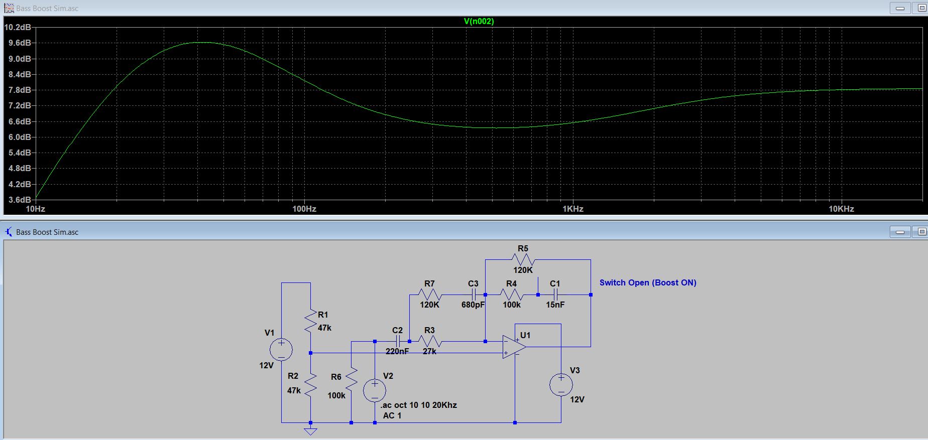

Ok thanks.I'm going to finish with these settings. just have a look.

Your new boost of only 4.2dB for 40Hz is barely noticeable and only 2dB for highs is not noticeable.
Your 220nF C2 feeding the 27k R3 resistor cuts 27Hz at 3dB so if C2 is increased to 470nF then the bass will be boosted more and go to deeper frequencies.
Your 220nF C2 feeding the 27k R3 resistor cuts 27Hz at 3dB.
You two are correct.The boost is un-noticable.I am repeatedly changing values and make checking...

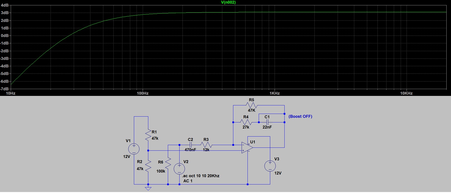

I have a small doubt how this happens.In below circuit the overoll gain is 1.42 (Non bass gain). But in simulator shows 3dB. 3dB is the gain of 2.How this 1.42 gain comes to 3dB?

3dB is a gain of 1.414 times which is the root of two. 3dB is a power gain of 2 times.
6dB is a voltage gain of 2 times and a power gain of 4 times.
You probably want a lower cutoff frequency but since your resistor values are low then the capacitor C2 value will be high and be very large (film type) and more expensive. Your signal source might not be able to produce low frequencies when feeding the low value of only 12k ohms.

Thank you very much.Thats what I wanted to know.The reason is after the boosting part the signal will goto tone control circuit.and after it will goto TDA amplifier.so the input weak signals may weaker more if I do not amplify a bit.
