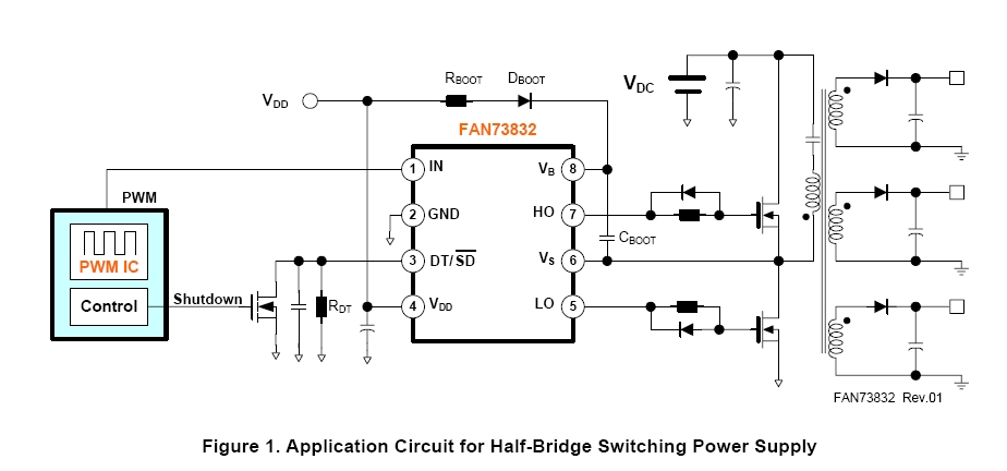

Here is a switching power supply. The two MOSFETS make an ‘amplifier’ that drives the transformer. (also pin 6 Vs). The output is switched to 0 volts (ground) and VDC (400 volts)
The bottom one if easy to drive. There is an amplifier from pin 1 IN to pin 5 LO. It drives the bottom MOSFET, 0 volts = off, Vdd = on. Vdd=15 volts.
The top MOSFET needs a signal on it’s gate that is complicated. The voltage from Gate to Source will be 0 and +14 volts. (14 not 15) While the source voltage is 0 and 400 volts. So the gate voltage will be 0 and 414 volts. There is an inverting amplifier from pin 1 IN to pin 7 HO. This amplifier gets it’s supply from pin 8 Vb and pin 6 Vs. While the bottom MOSFET is on VS=0 volts. Vdd through Dboct charges Cboct to 14 volts. Bottom FET goes off. Top amplifier goes on, Pin 7 HO pulls to 14 volts and turns on the top FET which pulls VS up to 400 volts VDC. This pulls up the top amplifier up. VS=400, VB=414, VH=414, Dboct blocks the 400 volts.
Simply, the bottom MOSFET stands on ground and pulls down. The top MOSFET ‘grabs it’s own boot string and pulls it’s self in to the air’. In real life I found this works best after much vodka. I got to 30 feet once before my shoestring broke.

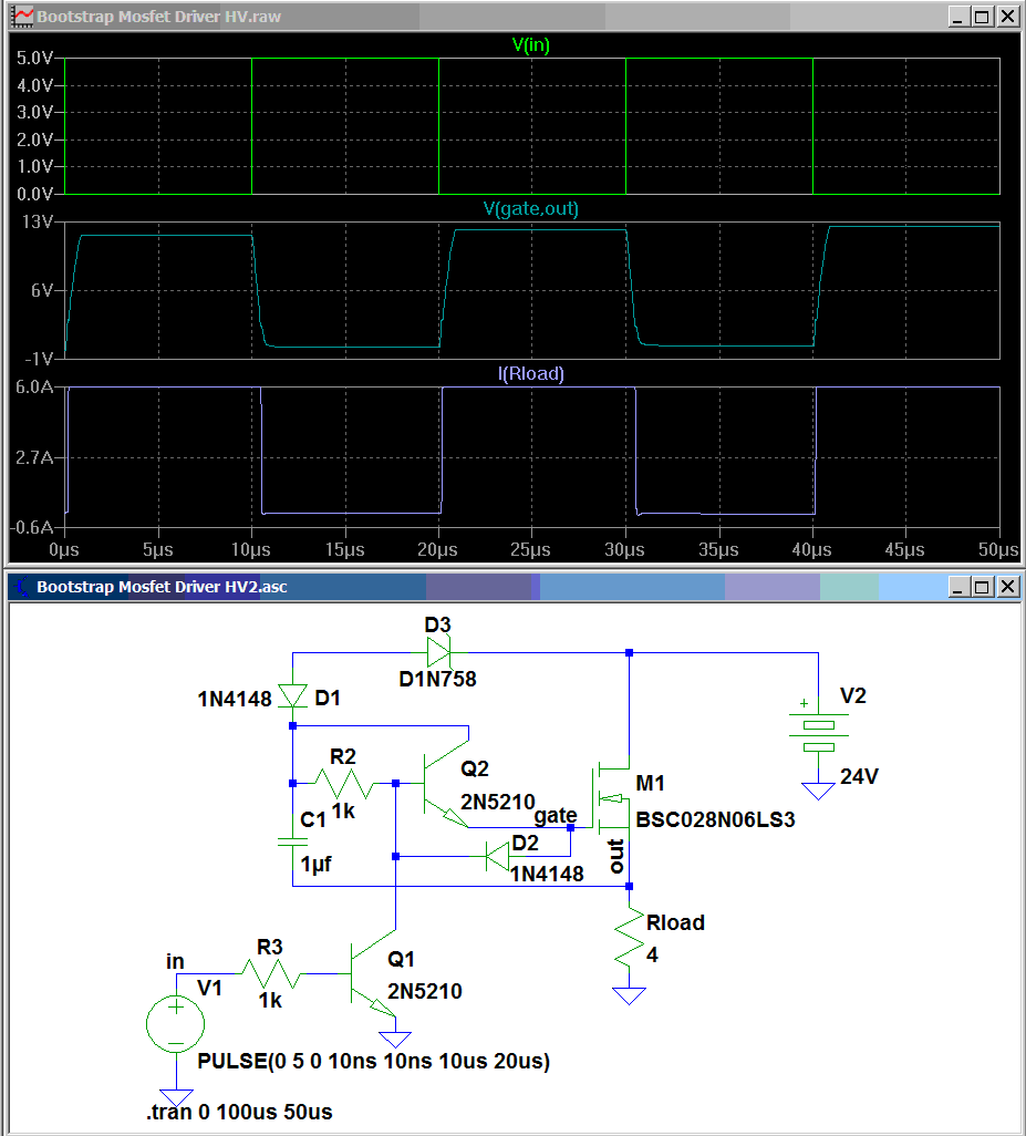

Here is a simulation using LTspice of a discrete bootstrap driver.
Zener D3 voltage is selected to keep the Vgs of the MOSFET between 10V and its maximum rating (typically 20-30V).
Q2 speeds up the risetime of the Vgs signal.
Bootstrap Mosfet Driver HV2.asc
