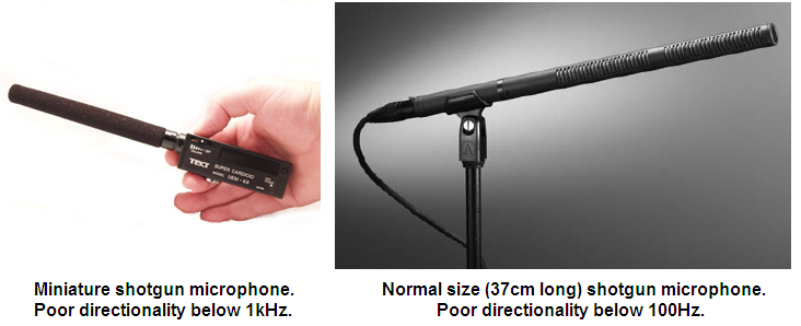

A shotgun microphone must have length for good directionality at lower frequencies. Even this "miniature" shotgun mic is huge and cannot be worn.
If you look carefully at the "minature" shotgun mic, only about 1/2 of it's length is taken by the acoustics, at least from how I see it. The other half appears to be the integrated amplifier and earphone monitoring system. The acoustical tube is nearly small enough to be worn. Poor directionality at low frequencies may not be a show-stopper, as hearing specialists well tell you that most of the information in speech is concentrated at the upper end of the audio spectrum.
I also found This Product It's only 8" in leangth, but the acoustics appears to be only about 4". At $49.99, it might be worth it to order and see if I can sperate the electronics from the mic. It would still look rediculous, but maybe I can re-design the wind screen to be less obnoxious.

That unit description says nothing about directional gain so it apparently amplifies sounds uniformly from all directions, which is not what you want. Perhaps you assumed it was a shotgun mike because of it's shape but I don't believe it is.
You've got a point, but I think it is at least a fairly high directional mike, and the description is just poorly written. I'll order from a site that has a money back gaurentee.
But, if he is just trying to get voice, the frequencies of interest are about 300 Hz to 3k so the low end isn't necessary.
