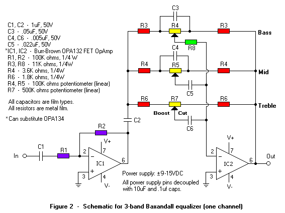

Ordinary tone control circuits do not use the pot you added called "pot A".
Since all pots are set the same then the frequency response should be flat, not cutting the highs and lows like yours.

The bandwidth for audio is defined as when the output level has dropped 3dB. Yours is 550Hz to 38kHz.
The 3-band tone control circuit shows that your pot A should not be installed,
pot B boosts and cuts treble sounds (maximum boost and cut at 20kHz),
pot C boosts and cuts mid frequency sounds around 1kHz and
pot D boosts and cuts bass sounds (maximum boost and cut at 10Hz).
Your circuit has something that is cutting most low frequencies and some mid frequencies.

Your first opamp U1 is biased correctly and uses R1 and R2 to also power an electret microphone.
Your second opamp U3 has its (+) input biased at ground so it will be a rectifier with severe distortion that might be messing up your graph. The graph shows levels that are extremely low (a loss of -76dB which is a loss of 5000 times).
Opamp U2 has no input bias voltage (its (+) input is floating) so it will not work.
Today your tone controls schematic has 5 parts values wrong. I circled them. the uncircled parts vaslues are correct.
The second pic I posted shows the frequencies and range of the tone controls.
The bass has its maximum boost and cut of plus and minus 20dB at 10Hz.
The midrange has its maximum boost and cut of plus and minus 20dB at 1kHz.
The treble has its maximum boost and cut of plus and minus 20dB at 20kHz.
When the tone controls are centered then the frequency response is flat from less than 10hz to more than 100kHz with no gain and no loss.

Good. Your new tone controls schematic has corrected parts values.
Opamps U2 and U3 have no DC input bias voltage so they will not work. Instead of R13, R15, C3 and C6 you just need two 100k resistors in series from +3.3V to ground making a bias voltage of +1.65V plus a 10uF filter capacitor to ground. Connect it to pin 3 of both opamps.
If R14 is 1k then opamp U3 will have a gain of 100 which when combined with the 10.8 gain of U1 makes the total gain 1080 which is way too much.
Where is a volume control? Your own voice might be much too loud.
Your frequency response curve is correct with no boost and no cut since the controls are at 50%. If you turn down the controls then they cut and if you turn them up then they boost their frequency bands.

U1 has a voltage gain of 10.8 times.
gain is R2/R1 (R1 is 1k and R2 is 100k) or am I missing something again?
The gain of your U3 is 1 or 100.
I don't know how deaf you are so I don't know how much gain you need. Also the tone controls add some gain if they have a boosted frequency band. Maybe you need gain to be somewhere from 5 to 50. A gain of 1080 is way too much.

You have TWO voltage dividers to bias the opamps but only one is needed because the input current of the opamps is extremely low.
You have TWO 10k resistors at each input of the TDA2822 power amp (one is the volume control) but only the volume control is needed.
You have wrong value capacitors in series with the 4.7 ohm resistors at the outputs of the TDA2822. They are not 0.01uF.
The first opamp has a gain of 10.8. The second opamp has a gain of 6. The TDA2822 has a gain of 95 but its volume controls are audio-taper so if they are halfway then the gain is 9.5. Then the total gain is 616 which is a lot. The total gain should be less.

Only ONE 100k voltage divider is needed since it can bias many opamps. Here it biases only two opamps. "Connect it to pin 3 of both opamps." But you have TWO voltage dividers, R16-R13 and R17-R15. Get rid of one voltage divider.
The TDA2822 needs a 10k resistor OR a 10k volume control pot to ground on each input. You have both which is wrong.

Pin 3 of the opamps is the NON-inverting input that has an extremely low current. It is used for a DC reference voltage that is half the supply voltage so that the output can swing symmetrically up and down from half the supply voltage.
Yes connect them together and connected to a single voltage divider and filter capacitor.
The inputs of the TDA2822 need a DC bias voltage of 0V. It is provided by a resistor to 0V. You have a 10k volume control on each input that provides a DC input voltage of 0V so your 10k resistors R8 and R4 are not needed.
