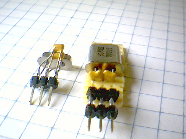

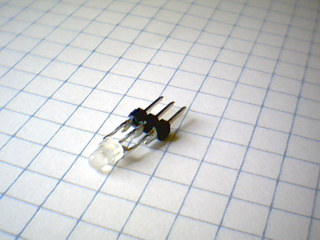

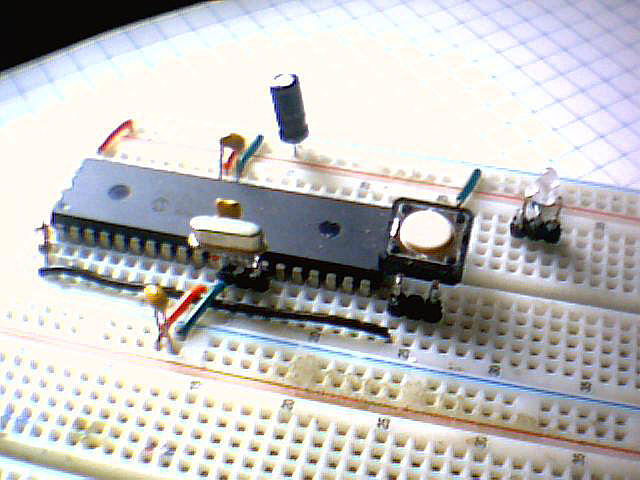

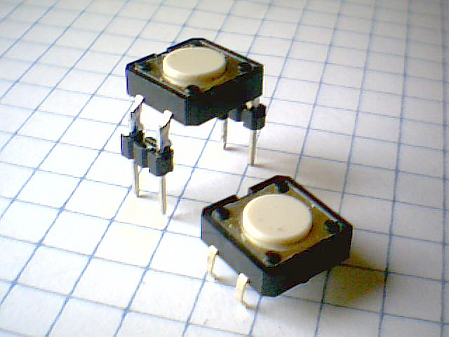

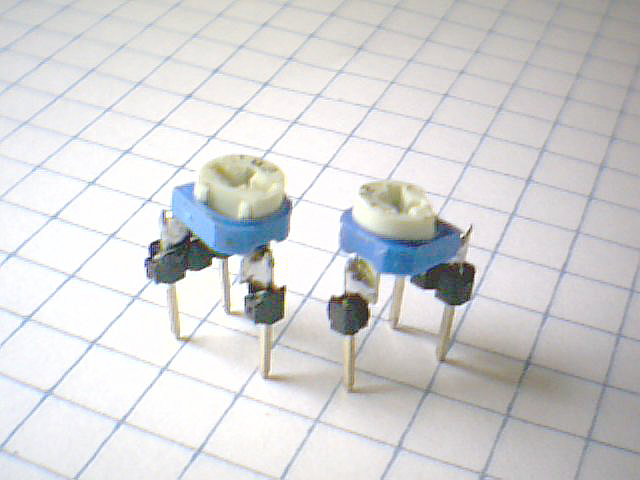

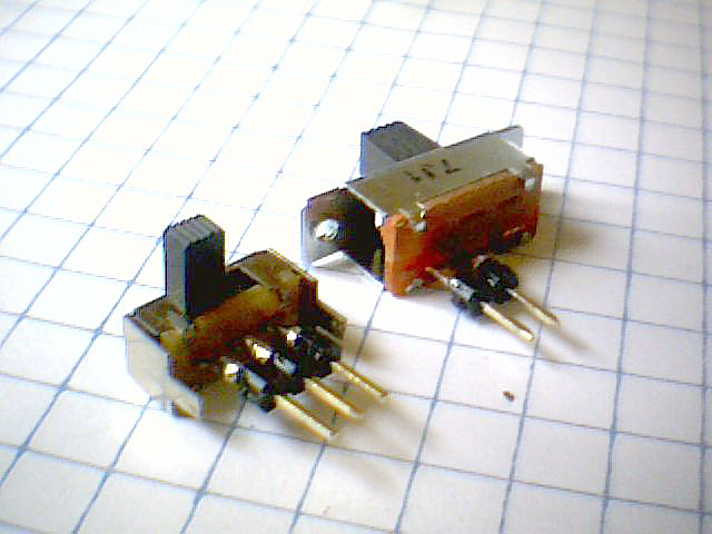

danielsmusic look at some of the neat things you can produce. I made this like 20 seconds each. Sorry if pictures arent the best. Im using a old 1.3MP webcam. I dont think that the header will add too much resistance since its way thinker than a normal trace anyway.
Hey Atom. I have a Digikey number for trimpots that fit the breadboard perfectly. They're accurate and very compact and pretty blue too. :D I'll post it after work tonight.
The one at the upper right:
GREAT! thanks i always having issue finding cool parts like that.
Nice to see site is up again. I always use your site as a reference point. :D
Nice new organization (categories)
The 10K ones I have are CT6EP103-ND. They have a full range of values though. Just search for CT6EP and you'll get the list.
The very breadboardable SPDT slide switches that I use are EG1903-ND. Very handy to have some of these.

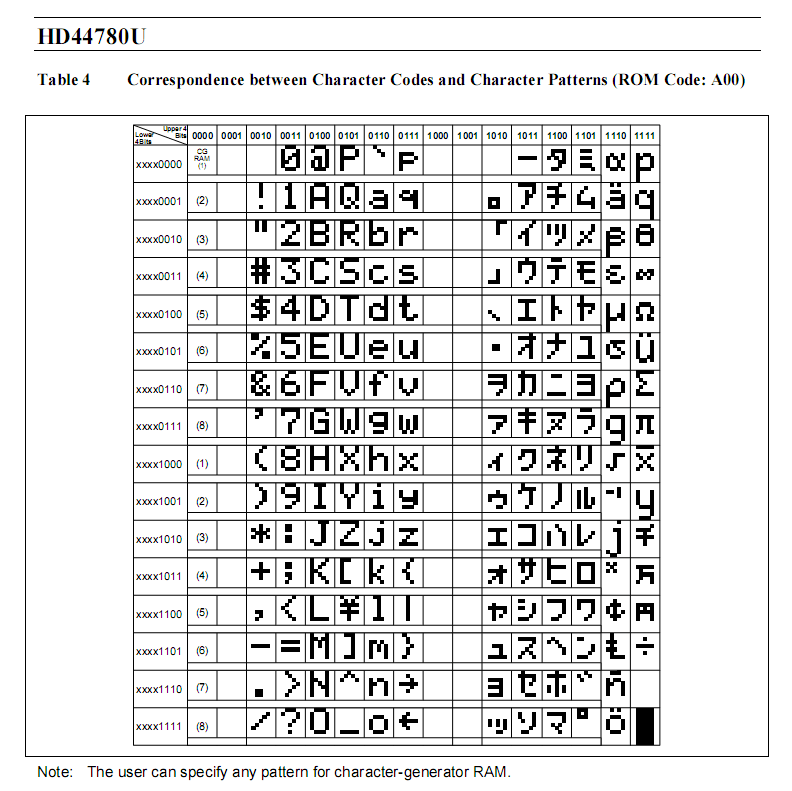

Hey futz! Could you tell me the ascii code for the degree character? The little circle before the C in degree Celsius, as seen on the picture of your LCD. I was trying to find out yesterday, but got all sort of strange symbols on my LCD.
According to my data its 0xDF , [DFh] for the degree, its actually a small upper square.
Thanks, Eric! That made the trick for my LCD. According to the extended ascii table, **broken link removed** , 0xDF is a "upper half block". 0xF8 is supposed to be the degree sign, but shows something strange on the LCD.
This image is the HD44780 character dot/bit pattern.
