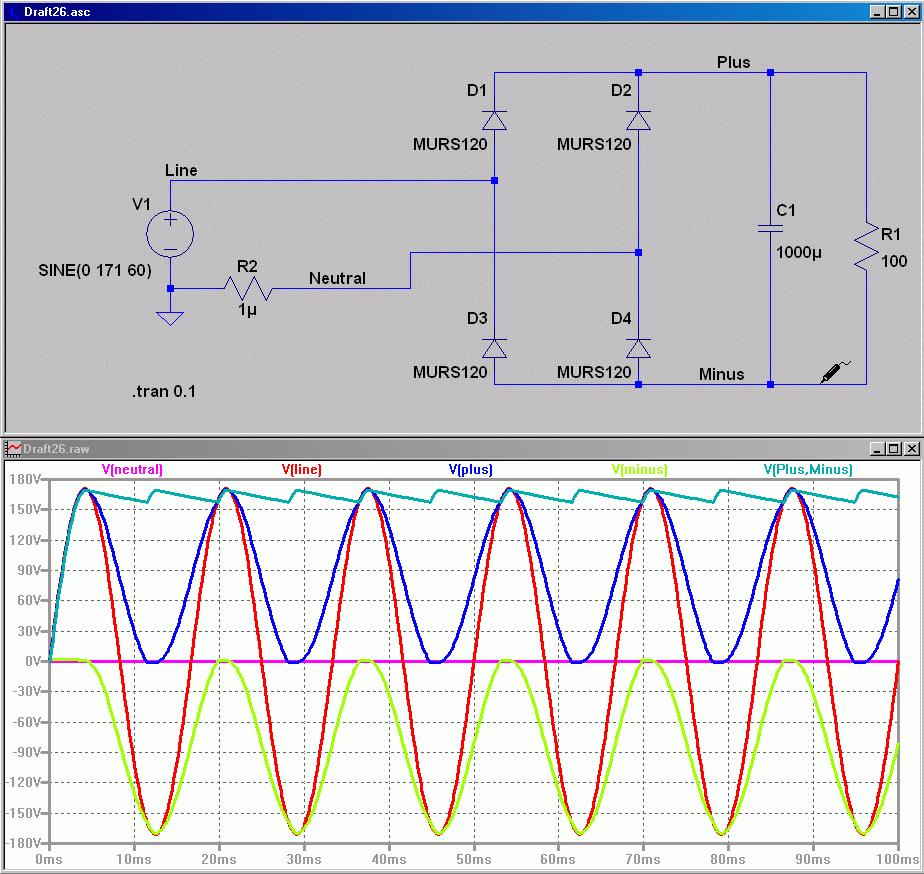

Stare at this for a moment. R2 is there just to fool Spice into letting me rename Gnd to be "Neutral"
Note what V(Plus) and V(Minus) are doing. Also note what the differential voltage V(Plus,Minus) looks like.
Still think you can tie "Minus" to ground?

Thanks Mike for sending the waveforms. Yeah they are not at the same potential I understood that. What I am still wondering is during the negative half cycle, V1 is going towards -170V. In this case how V(plus) is reduced to 0V. Just for learning purpose, I am curious by which path V(plus) is decreasing.
In the negative half cycle: D2 is reversed biased initially. (because V(plus) is higher than V(neutral). D1 is reverse biased too because of the same reason. Where is the path then??

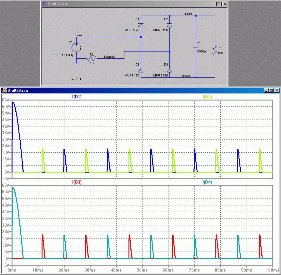

Here are the currents through the four diodes
