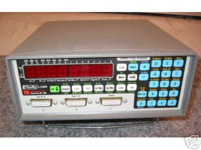

Data Logger the easy way
Now I can't be accused of advertising ...
EBay just sold a Thandar LA160 data logger (upto 10MHz sample rate) complete for just £21.50 + £5.00 postage.
You will work hard to beat that for a cheap and easy solution to your problem ...
search EBay for item number 3834498548

Of course! I'll tell ya.. over the years, I have seen some fantastic deals come and go on ebay for electronics equipment.. Alot of it is certified junk though (in most cases the seller doesnt even know it!) But there is plenty of good stuff to be had.
I had been under the impression that the original poster was wanting a learning experience though, by making his own since 8MHz isnt so fast that you can't get away with a crude design. My Grandmothers logic analyzer is faster than 8M sample rate so I assume he would have bought one (10Meg or better) by now if he was so inclined...
_or_ he's been hiding in the basement all these years and doesnt know about ebay!
