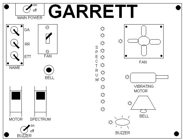

I guess if I use a breadboard (which I've never used before), I'm concerned about how to "encase" it. I see that you mentioned using a gearbox made of clear plastic, but I'm not quite sure what you mean. You mean pull one from something that exists, or can you just buy one?
I was just thinking of using a piece of thin wood or something, and then drilling holes in it for all of the "visible" parts on the outside. Then, all of the guts and the connections would be behind the front panel. Then I could close up the front piece somehow to make it like a box and make it portable. I guess I could also just get some kind of plastic case (like a pencil box or something) so it would be lighter.

See attached for a very rough draft of what I'm trying to do...

I would use wood or plastic to make the panel and enclose the insides like you mentioned. Whats the "spectrum" in your drawing?

The spectrum was just gonna be a bunch of different colored LEDs...maybe in some kind of spectrum or rainbox pattern.
