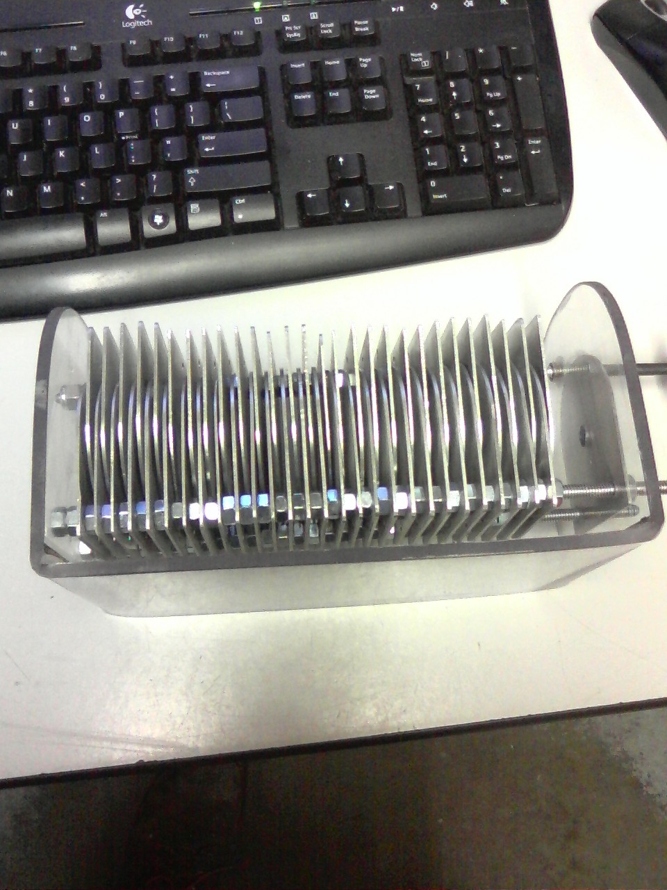

Just for kicks heres my home made air variable cap. :) Not sure how well its going to work yet. Getting the plates to not touch was a hassle, and the spacing is not as even as I would like, so It might be kinda (really:confused:) touchy to tune. I want to get my loop made this weekend so I can give it a try. Not the best picture, but give the general idea. Here is a short video showing how it adjusts. YouTube - Home Made Air Variable Capacitor

Don't mean to be a wet blanket, but the arc of the curved side of the moving D plates should center on the axis of rotation.
Is that just to make for smooth, linear adjustment? Or am I missing somthing else?
