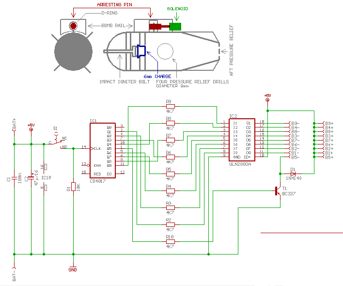

Anyways what I would eventually like to build is a controller that I could plug in multiple micro linear servos or micro solonoids to drop little paratroopers or dummy bombs onto targets. The catch is that I would like to be able to avtivate all bombs using one single channel on my transmitter but I dont want them to all drop at once. I would like to have it set up so that when I push the button once, it drops the first bomb. When I push the button again, it will move on to the next servo dropping the next one in line so I can drop as many, or as few as I want, whenever I want using that one channel on my reciever and transmitter.

If you want to do it electronically with one channel running many servos one at a time, you need to programme a microcontroller. It needs one pin for the input from the receiver channel, and one pin for each output. Plus power pins, of course.
It could be that someone has already done this and a commercial device is available. A microcontroller will cost nearly nothing but will take time to write the program.
It could be done with logic gates but it would be huge and hell to make.

I dropped bombs from a model plane using that method:
To keep the circuit small I used a maximum of 9 bombs being triggered by a servo with a micro switch providing the clock signal for a decimal counter (CD4017). The outputs of the counter were wired to small pull solenoids being controlled by low power transistors.
The bomb was released when the solenoid pulled in.
To use more than 9 bombs you could cascade decimal counters.
Here is a sketch containing the construction details of my bombs and a circuit to release the bombs. The bombs were made of CO2-cylinders.
If you will use the same kind of bombs (making noise and smoke) don't forget to drill four 8mm holes into the cylinder. Otherwise the bomb will turn out as a real bomb!

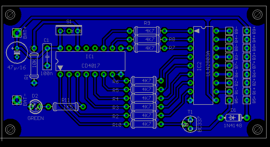

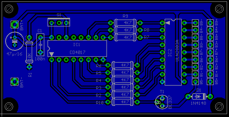

Hint: To make sure the counter is in RESET condition you might connect a low current LED to pin3 (Q0) via a 1.5K resistor. Otherwise you might drop a bomb before take-off. :) (see 2nd board design)
