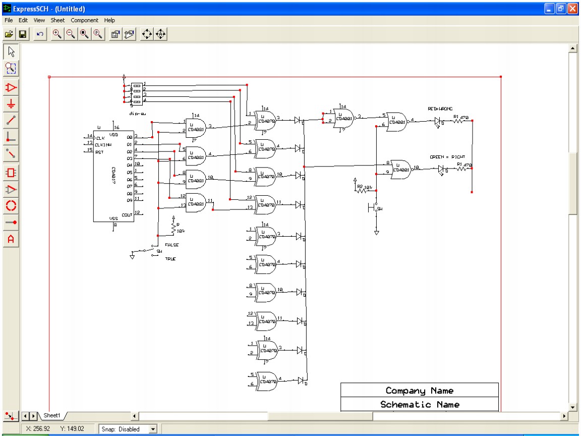

Hi, i'm building an electronic quiz for my school project but i'm a little confused as to what to do.
I'm going to be making a quiz where there are questions displayed, and you have 2 levers for true and false. If you answer correct, green lights will flash (i'll be using 555 timers for that) and if you answer wrong red lights will flash. However I don't know how the machine will be able to know which questions are right and whitch ones are false (there are 10 questions that are going to be in order and they are labelled numerically so you have to do them in order). When you answer a question, you just remove it from the machine and go to the next one. How do i get the machine to recognize the answer to the question and display the correct lights? Is this anything related to programming chips or something? I'm confused:p
here is a pic of what i'm trying to do and a circuit diagram would be very very helpful, even if it's not detailed.:)

my first thought is have 10 DIP switches
ON = TRUE
OFF = FALSE
set switches in accordance with the questions
can then change the qestion order / as well as reset the DIP switches
an array of AND gates would do the trick.

here is a start
just add 6 more key code switches (true false answers pre programed)
have one switch for the data entry switch but using a shift register or even a 4017, select each of 10 inputs to the 4070's using AND gates ??
YOU need to figure out the logic
YES this is doable
YES this is doable

Her you go
This is enough to get your homework started.
you need to add more AND gates and dip switches.Don't forget the resistors on the dip switch/4070 as in the like I sent earlier.
you need a de-bounced monetary push button to clock the 4017. A 555 mono is easy and clean or use leftover gates.
then you need to draw up a truth table

FIRST draw up a truth table of each event-correct answer, wrong answer.
write down what each gate outputs. This WILL assist you in learning and if it doesn't work then why.
A simple logic pen comes in handy (an LED, a resistor and an alligator clip)
look up logic pen circuits. this will really help a lot. Sometimes simple is the best (less to go wrong).
