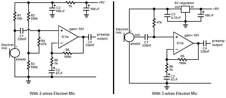

dear audio guru,
I have made this circuit as per schematics with TL071 and ur modifications, completed last night. Circuit seems working ok as pre amp but it is not sensitive as i have to eat mic to get sound from my amplifier.
Maybe your electret mic is a 3-wires one instead of a 2-wires one.
Maybe your electret mic is connected upside-down. Its metal case and the pin connected to it is supposed to connect to 0V.
I don't know which circuit you made. My mic preamp circuit that I attach here again has a voltage gain of 101 which is fairly sensitive. My instructions say to inrease the value of R3 for more gain.

The red and white microphone wires should not be connected to the same place.
Leave the red wire where it is, and connect the white wire together with the shield (screen) to ground (common, 0V).
The resistor which gives power to the microphone is wrong. It it 150k (brown, green, yellow, gold), but it should be 10k (brown, black, orange, gold). 4.7k (yellow, violet, red, gold) would also work.

Thanks for ur feedback audioguru, here it is ...
My mic is of two pins NOT 3.
yea it is metal case is connected to 0v with shield.
: ( it is the same circuit about which another member said and you quoted. ( i just added a 9v regulator IC because i have to run it from 12V car battery.
by the way, it could be too much as ask about the gain set at 100K as im not sooooooo good in electronics, if some tell me how to check gain then i can.... :)

thnx friend,
mneary :
i will change that wire.
wao.. you pointed out correctly i didn't checked that resistor its very much may be it is causing problem as it is not picking voice. I will change once i got back home (i am at work) and let you know.
audioguru : my mistake : ( sorry !
in the evening i will first do as mneary pointed and hope circuit will work as u designed : )
sorry i have not learned much so i dont know about the deep working of components like formulas you use to calculate things, i just make circuit what i require as per you electronics gurus' schematics, but i would like to get this knowledge so some day i could design circuits : )
further please let me know i have to keep mic far from the computer (around 5 meters) so which wire could be run long the mic one or the output (that is going to the computer mic jack) please let me know.
thanks audioguru and mnery, i will let u know after required changes.
Thanks friends for your time and help, i have changed that resistor with 10K and it just start working.
As for mic i used only two wires (white wire NOT grounded with shield) beacuse of this image attached; fig1. (1:signal, 2:5v, 3:Ground)
when i connected preamp output to mic jack pin1 and pin2 both tied together it was producing lot of noise, how ever i connected preamp output as shield to pin 3, and signal (redwire) to pin 2 and that bomardment noise vanished (i dont know why ; i am attaching image fig1 which i got from a website, according to them pin 2 is 5v; pin1 is signal)
simple mic is working ok in this config fig2.
any way i hook it with only two wires shield and ring at mic jack and got low noice (only humming and speaker feedback is there)

Picking up of scratching over table,mic,wires doesn't measure the sensitivity of mic. All will pick those. If you're using 100% volume with 'mic boost' on computer, then it is not even sensitive anywhere near standard level.
That is a 3-wires electret mic. My circuit is designed for a 2-wires electret mic and needs modifications to work with your 3-wires mic.
When i connected preamp output to mic jack pin1 and pin2 both tied together it was producing lot of noise, how ever i connected preamp output as shield to pin 3, and signal (redwire) to pin 2 and that bomardment noise vanished (i dont know why
Of course the 3-wires mic will not work when you short its pins together. Pin1 is +5V, pin2 is the output that probably needs a coupling capacitor to feed the preamp and pin3 is the metal case and is ground for the shield of the cable and is 0V.
Your attachment did not work. We don't know which way the pins on your mic should be connected. Try it both ways.

There should not be any hum. Hum is caused when the pins on the mic and the shielded cable are not connected properly.
Here is a 2-wires electret mic and a 3-wires electret mic with the ways they connect to a preamp circuit:

1. yes of course i am using two wires mic.
2. friend i am using two pins mic with your circuit and have to feed output to computer mic jack that' it so i dont need to keep mic on my lips and of course it is not possible when i am driving my car, the only best place i can fit that mic is around 2 foots.
3. the attachment was only to show you people that what i did with circuit and computer mic jack to connect (finally i connected wire 2 and shield of jack with circuit output and its ok)
4. that mic in question u said connected wrongly was a zoltrix clip mic i purchased in my child hood :)
i just break the case and pull out the elektric mic with its own wire and stereo jack)
5. yes humming gone when i changed microphone with new one, and put all that kit in a plastic box with stereo jack and dc power jack out. I will post pic later. First i have to check it in my car ; )
6. but there is slightly a noise like air or some thing like that ( i mean speaker is not quite when i am not speaking in mic, it should be quite enough so that my voice recognition software pick my commands clearly and of course i will enhance the capability of project)

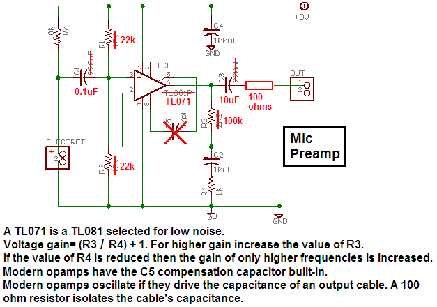

Hello audioguru,
Can I use 5V (or 12V) instead of 9V as PWR IN.
You forgot to say which microphone and which opamp you have.
My mic preamp uses an electret mic.
It uses a TL071 low noise opamp that has a minimum supply of 7V so it might not work with only 5V.
The circuit works fine with a 12V filtered supply.
Hello Audioguru,
Thnaks for your reply. I am using a normal condenser MIC and is planning to use TL071 to increase the sensitivity of the MIC. Its quite not comfortable to hold the MIC in front of the mouth for clear sound. I am planning to use the 12V ,from the spare available on the PC SMPS. Hope electret MIC is same as a Condensor MIC, available in the normal PC headphone/Mic assy.
A condenser mic needs a 48V supply. An electret mic is similar to a condenser mic but it has the 48V built into its electret material inside and has a Jfet impedance converter. The Jfet needs to be powered with 0.5mA at a few volts. Most modern inexpensive audio devices use an electret mic.
Most shops call both a condenser mic.
The 12V from a pc is very noisy and will need good filtering to power your extremely sensitive mic preamp.
would there by any benefit in terms of noise if this circuit is converted to dual supply with two 9V batteries?
I am also considering using the OPA134 which was suggested to me by audioguru.
also, will the use of potentiometers on the electret bias and opamp gain resistor influence the noise level? I am currently using metal film resistors and I suppose the potentiometers (multiturn high quality) will be more noisy?
It won't make any difference.
I never used one because I don't use extremely high gain for a mic preamp.
Will the use of potentiometers on the electret bias and opamp gain resistor influence the noise level?
The circuit does not need a pot to adjust the bias on an electret mic.
Use a gain pot if you want.
You will find that background sounds will be much noisier than electronic noise from the circuit. You might hear some electronic noise if you turn off the mic.
