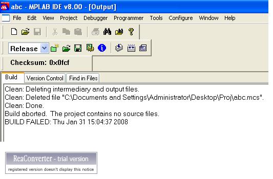

When i was making project in MPLAB - i encountered the following problem.
Page 30 of this pdf says - there should be no errors...
But i am getting the error as shown in the thumbnail...
Any suggestions...

You have to add the asm file to your project. You can do that from the Project menu, for example, clicking 'Add Files to Project...'

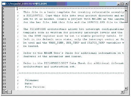

According to the MPLAB Manual... the template file ( .asm file ) should be automatically created by MPLAB as shown in this thumbnail...
But here i've not got any of that...
Please check if this problem can be solved...
Please see this thumbnail also that tells .asm file auto created...

No, according to the guide you can select a template file to start a project.
ADDING FILES TO THE PROJECT
Step Four of the Project Wizard allows file selection for the project. A source file has not yet been selected, so we will use an MPLAB IDE template file. The template files are simple files that can be used to start a project. They have the essential sections for any source file, and contain information that will help you write and organize your code.
I would suggest that you start a project with a new blank asm file and copy&paste the template code, without overwriting the original file.
ok.. i got it..
and i made the project easily using new asm file...
but problem comes as how can i copy that template code... (optional )

Simran jee, how come you get abc-MPLAB not MPLAB ? and did yoo see the note at thee nd of the clipping you loaded on your 1st post? registered version doesn't get this notice?

If you must know, abc is the name of his project, albeit without any source file inside.

LOL. The trial version notice in the jpg is for the imaging software he is using to made the screen capture.
It has nothing to do with MPLAB.

I am sorry but i wanted to say that the manual is having one small mistake on page 27 .
Hence, correction is needed for MPLAB Getting started manual.
The manual can be found on first post of this thread.
It should be written:
C:\Program Files\Microchip\MPASM Suite\Template\Object
\18F8722TMP0.ASM
It is written:
\18F8722.
