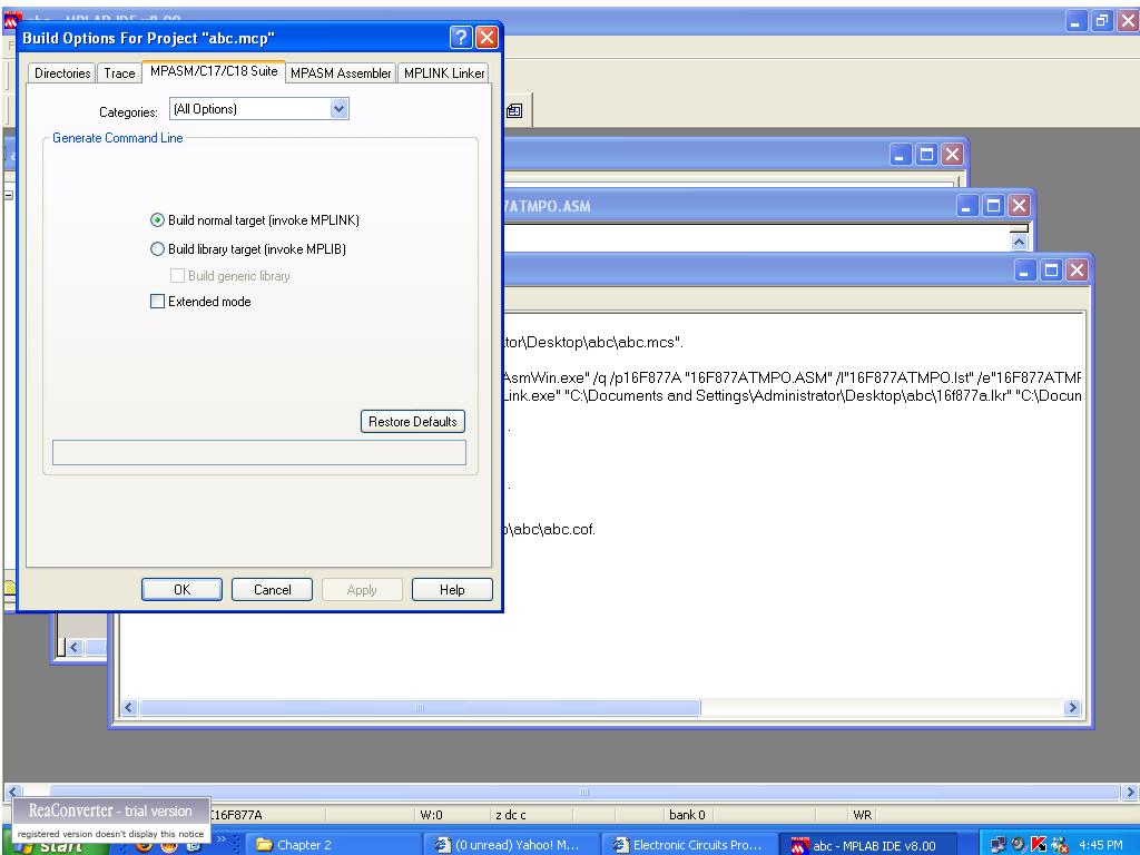

Hi Simran,
From the Project Menu, in MPLab, choose Build Options -> Project. Select the MPASM /C17 /C18 Suite tab. Click on Build Normal Target (Invoke MPLINK), rather than Build Library Object (Invoke MPLIB) (which is probably selected in your case.) Then click OK, and make your project.

You should still do as BeeBop says as this is the likely cause of your problem and it is exactly the same in version 8.0.
Ok...
Now i understand what Beebop was saying...
I tried , everything went well...
but Sorry... didnt got hexadecimal file...:eek:

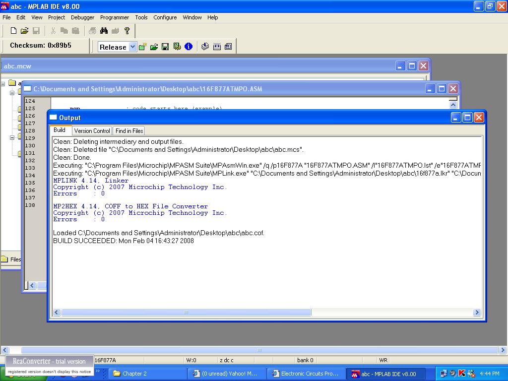

Hi...
:eek:
Sorry for bothering again...
See...
Two thumbnails have been posted...:eek:

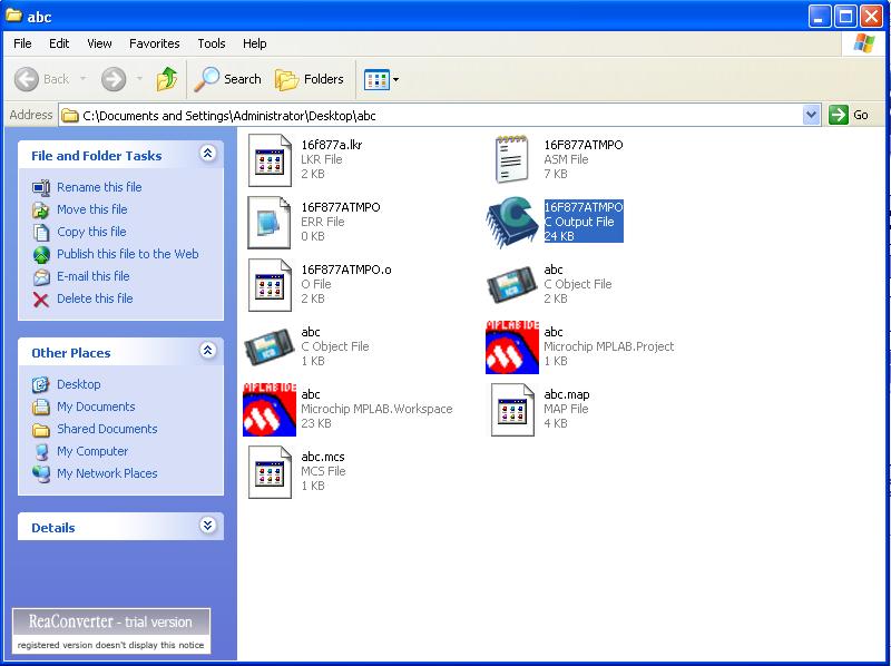

Have you tried doing a search for 16f877ATMPO.HEX, it should be in a folder called abc on your desktop.
Hi...
Hi Mike,
You are right... it has to be there... but, i feel it has been converted to some other file... see..
Regards,
Simran..

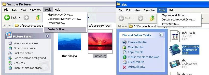

You have the file extensions hidden. In that folder go to tools>folder options. Click the view tab and find the "Hide extension for known file types" and untick it.
Do not have the file extensions hidden.
It's one of Windozes worst features.
How could you tell whether someone's sending you a text documant or a virus program, if you can't see the extension?

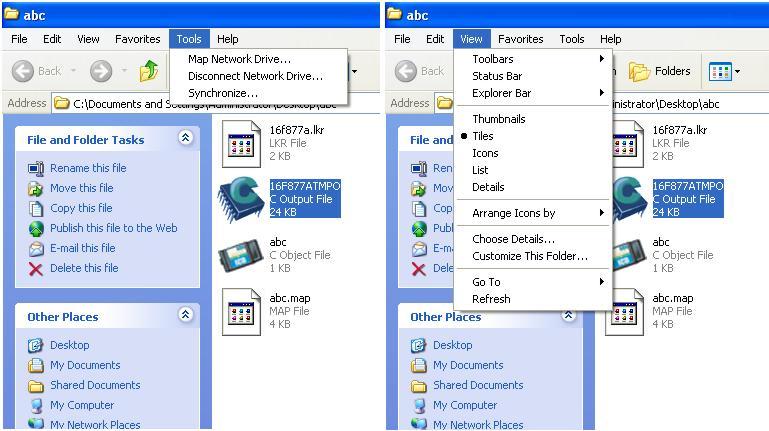

Thanks for helping...
Please check the toolbars in thumbnail...
Regards
Simran..:)
I'm guessing that you have to be logged in as administrator to change it.
Thanks...
Thanks mike and everyone...
I feel i can retrieve the hexadecimal file by right click > open with > notepad.
As the tools menu in my folder is not full ...
Also there is no folder called " Folder options " in my computers control panel.
See the comparison...
Regards,
Simran..
