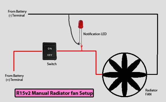

I got an Yamaha r15v2 motorcycle. In my motorcycle the ECU got some problem in it. The radiator fan doesn't works automatically. So i made a ON/OFF button to control my radiator fan manually.
But my question is how to make it automatically without changing the ECU(its too cost man)?

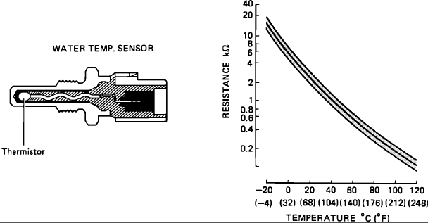

I got a coolant temperature sensor, which gives me the output as ohms Ω. When my coolant temp sensor gives 310 ohms as output, automatically the ECU gets the signal and switches ON the radiator fan relay.
My question is how to use the coolant temp sensor to switch the radiator realy ON/OFF automatically without the ECU.

Your coolant temperature sensor, in series with the appropriate fixed resistor, could be used as a "voltage divider" to provide a signal to a simple comparator (like an LM111). The LM111's output could drive a small relay that could then control the radiator fan motor.
Is this what you had in mind? And, if I may ask, how comfortable are you constructing small electronic circuits?
<EDIT> Hysteresis is also a consideration. With that in mind, the LM111 might not be the best comparator choice. I'm looking into that.

Also have you seen the last image i attached. In that you can see the resistance varies from 20KΩ to 0.1KΩ. My question is to exactly switch on my radiator relay by 0.3KΩ.
The comparator circuit should have some hysteresis (i.e. a change of several degrees, rather than a fraction of a degree, would be needed to make it switch), otherwise the fan will be on/off/on/off continuously.... like a tart's drawers :D.

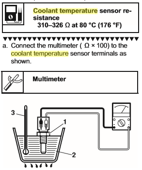

Yeah, i am planning to remove the relay connection from the ECU and i am going for the new circuit with new relay for my radiator fan. I will get the input from the coolant temperature sensor, which is already in my bike. And according to the service manual the radiator fan starts if the resistance from the temperature sensor is EQUAL to or LESSER than 326 ohms.
Exactly by 80 degree Celsius, the thermostat in my motorcycle opens the gate for the coolant present in the radiator, until that heat(80 degrees) the coolant which is inside the water pump will cool down the engine which in turns there is no need for radiator fan. So at 80 degrees the thermostat opens the gateway for the radiator coolant and it needs to switch ON the radiator fan. So the temperature sensor will get the resistance of 326 Ohms exactly by 80 degree Celsius. So i need to get a circuit to operate the radiator fan exactly by 80 degrees and above. Since the engine heat gets higher and higher the resistance from the temperature sensor gets lower. so have to design the circuit switches ON the relay if the resistance is EQUAL to or getting BELOW 326 Ohms.
