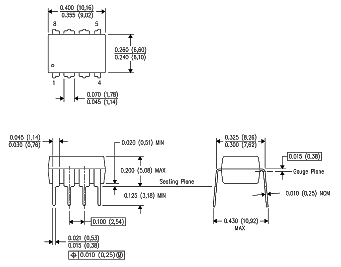

Eight-pin plastic case? What is that. Can u show me an image. Already said u I am dumb in electronics. Lol.. I am a computer science engineer.
Here is a drawing of the 8 pin plastic case that contains N1A and N1B. The pin numbers correspond to the pin numbers shown on the schematic. The drawing is from the LM393 dual comparator integrated circuit datasheet: https://www.ti.com/lit/ds/symlink/lm2903-n.pdf
When you build the circuit it would be best to put the LM393 in an 8 pin turn-pin IC socket. You first wire the socket into your circuit and then plug the actual LM393 integrated circuit into the socket. Note that you should only use a turn-pin socket for maximum reliability.

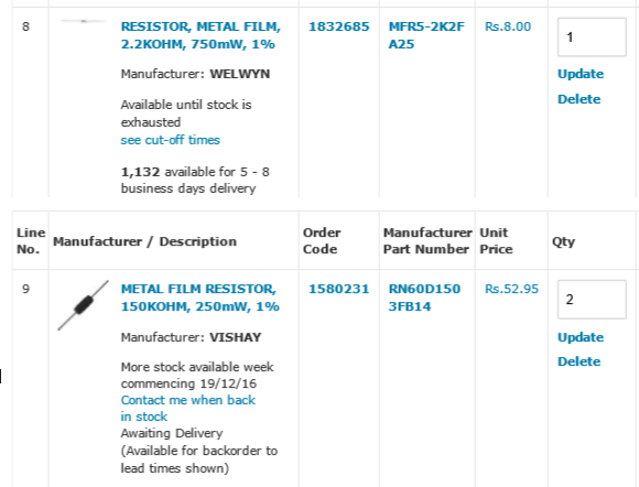

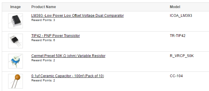

Can u please check the components i choose to order online, Will order it after your confirmation.
Hi pradoartz,
Some of the components on your list are not quite correct. If you send a link to the supplier you wish to use I will see if I can do a list for you.
spec

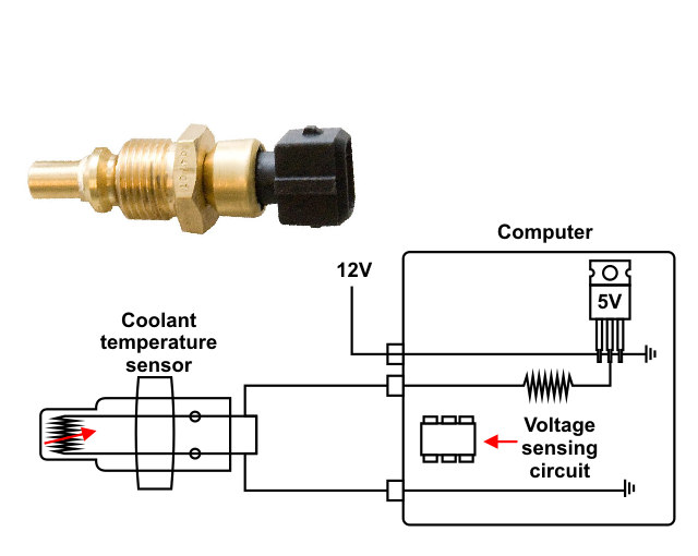

I think this links below can help you understanding the query.
https://priuschat.com/threads/arduino-automatic-coolant-temp-hack-for-better-mpgs.90418/

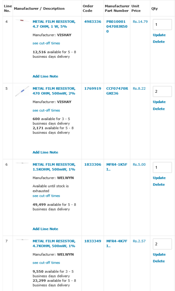

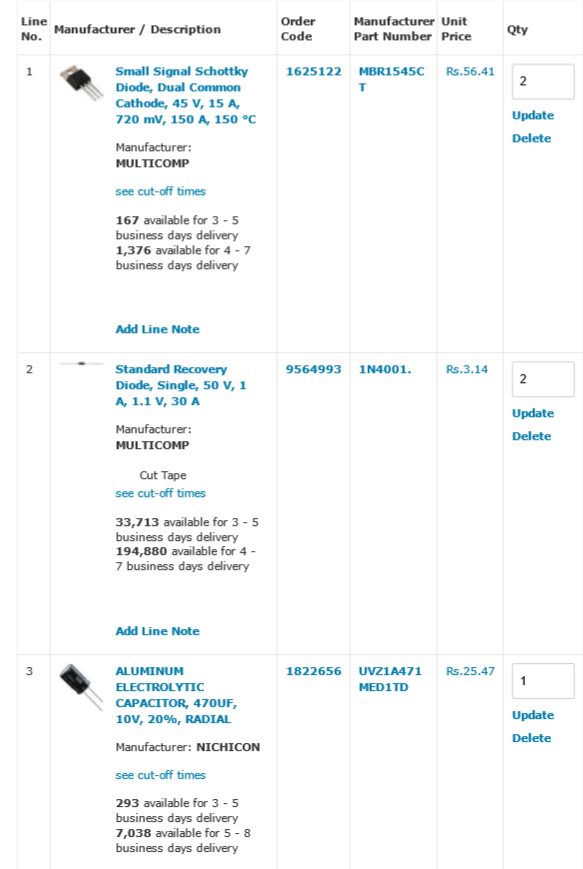

Hi pragoartz,
As promisede the bill of materials (BOM) (parts list) for the circuit of post #26 is attached to the end of post #26.
I tried to find most components on electron.com because they are cheaper. Other components are from Element14.
That will mean two orders, but if you would like to order all parts from one supplier I will revise the BOM to source all components from Element 14.
