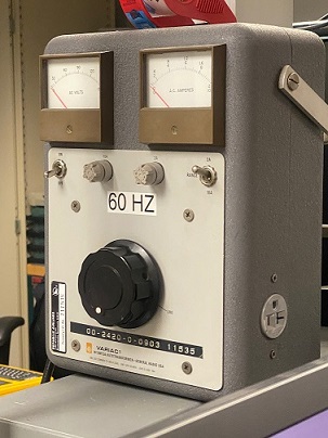

I have been working on restoring an old Variac control panel and am at the point of installing my new power cable. The original box (which I am reusing) had a hole pattern cut into the rear of it where the power cord entered the unit, but there was no grommet or strain relief. I was curious if anyone recognizes the hole pattern and could recommend a replacement part? Here is the existing hole pattern:
The center hole is 1.125" diameter, and the two smaller mounting holes on the sides are 1.75" center-to-center. Anyone seen these before?

Someone suggested a twist-lock recessed plug, like the NEMA L7-15, but those seem a bit too large for this knockout. This unit houses a 20A variac, so presumably it was designed with a 20A plug originally. Not finding many panel-mount plugs that size and rated for that current though.
It would almost fit a NEMA 5-20 recessed receptacle, though those still seem to be on the large side.
I was thinking of this: https://hubbellcdn.com/specsheet/WIRING_HBL5278C_spec.pdf, but it isn't.
There was a connector that I purchased from newark.com, probably Hubbell that was basically a flange mount twist lock. The wierd thing about the specification was 125/250, but it was grounding.
This https://www.mcmaster.com/6755K222/ comes close mounting wise, but it's not grounding.
Here https://www.mcmaster.com/6755K172/ is the grounded version. The one I used was dual marked like the one above.

Late to this thread... for what its worth, I happened to work with several legacy brand 60Hz/400Hz Variacs in Avionics field, most of which are either out of biz. or taken over by other firms. Across the board while there is a separate input line, there is a similar opening on the right side side of the case meant for "output"
That looks about right, though this pattern is on the rear. Two separate receptacles were used on the front of the panel for outputs, so whatever the holes were originally used for I suspect would have been the supply connection.
it could also be a split clamp strain relief. it's a sheet metal plate with one half of the clamp that mounts to the panel, then the other half of the clamp is attached to the stationary clamp with two screws and tightened down on the cable. i've seen them on older pieces of equipment, but i don't think they're made anymore.
