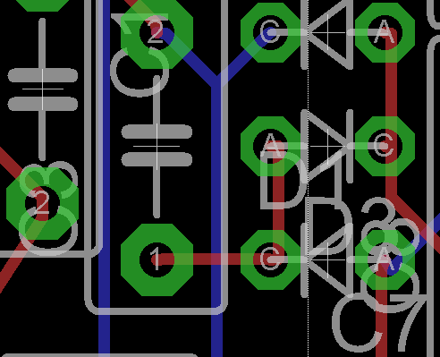

ok here is pcb! I chose the right sized caps this time , and had no trouble designing my custom parts, and silkscreen was np, but i decided to leave it out since it caused too much clutter.

i found cheap board house, http://www.custompcb.com/, for only 80$ i can do 25 of these, i just want to hit the send button, but i fear there is something im forgetting, how does it look?
plspls i wanna hit send soooo bad!

Should I be really picky?
C3 is on top of pad, C1 on pad,
D1,D3,C8,C7 touching
T1 and a LED are touching, C13&C7&C8 touching
You have Q-transistors and T-transistors.

Good first board!
Also another new idea. If you use the "name" button, in SCH or in BOARD, you can name nets. Now your nets are in the default format. "N$26", N$27" etc. You can have names like "supply", +5V, "gnd", "BofQ4", Don't go wild but at least name power and ground and anything special. When you are laying traces it is nice for the name to pop up and announce "+5V" so you can make the trace thicker. A little trick to help you know what trace you are dealing with.

Picky is good when in training!, I had noticed some of those overlaps mentioned, and fixed the ones i had to, but figured most of the white layer wasnt important since it is not silkscreened yet , and prolly wont be with this one, also i "faked", transistor T1 is actually a TSOP photo transistor, but that was closest i could find. Q1 is pnp T's are NPN.

In Eagle run a design rules check on the board - it's near the bottom of the toolbar and shows DRC when you hover over it. It will show you any errors and some manufacturers supply a DRC file so you know you are complying with their rules. You should also run an ERC (Electrical rules check) on the schematic.

back to this pcb though, that was a little complicated/confusing getting the gerber files out, again i dont even want silk screen ,is this ok?, is anything missing? also at which point did i define dimensions, was that the purpose of the polygon squares>?
