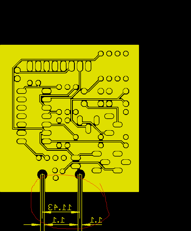

I've created some image plots of the gerber files in your zip file. These were done with a tool I use to check gerber data (DFMNow) before sending to a Fab house.
You might want to review these before submitting. I wasn't sure what some of the files represented. Some fab houses require the files be named a certain way.

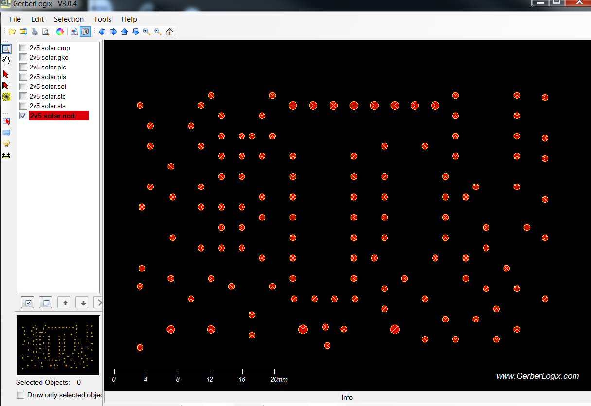

Anyway, I think you should recheck the drill file.

eTech,
Do you want the dimension markings on the sol layer?
i think im finally getting these layer things, good thing that error will fall out of board space...
my ncd is different , as per youtube tutorial, i encode ncd as excellon, and rest as gerbert_rs247x......i doubled chked with gerberlogix looks ok from here, ima contact board house quik
:wideyed: You'll have to ask DrD that question. If it were me...of course not.
My guess is that information is in the gerber data. Why its there?...heck if I know. That's why I suggested reviewing the files.
But I'm also not familiar with the file naming convention used either so I'm not sure what each file is supposed to contain.
I also noticed the drill file (I think that's what it is) content looked a little strange.

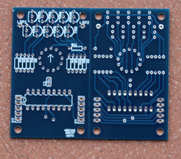

very nice, i just got my order in now, finally!, i notice that line down the middle of your board, are you going to cut it later on? does this save money? and what board layer is that on.?
hmm. , maybe now with these nice clean pcb's, i can switch to smt components? is it much harder to solder?

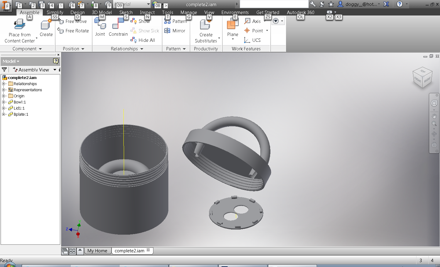

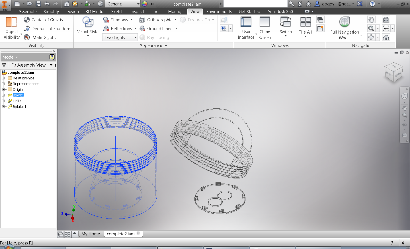

in the meantime i have been working on these cad models, and finally got a sales quote by a Co in my local city, it took these a couple tries as well to export. for all three parts its going to cost 450$ does that sound right? my model is only like 10 x 12 cm, and hollow.
this is also the one i posted earlier:
The picture above is two boards side by side to show the front and back layers.
I assume the cad quote is for 3D printing. $450 sounds expensive but I've nothing to compare it with.
pfft., 450 wat a rip , i found a local library that does 10cm^3 prints for free,, at 450 i can practically buy my own printer....or build !

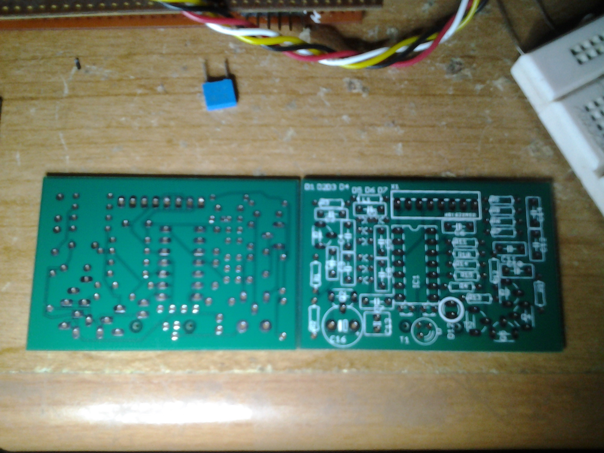

however circuits turned out good aswell!> and for some reason marks didnt show on solder layer ( i never changed it)
30$ for print, and 30 for delivery at PCB way, :) so cool
