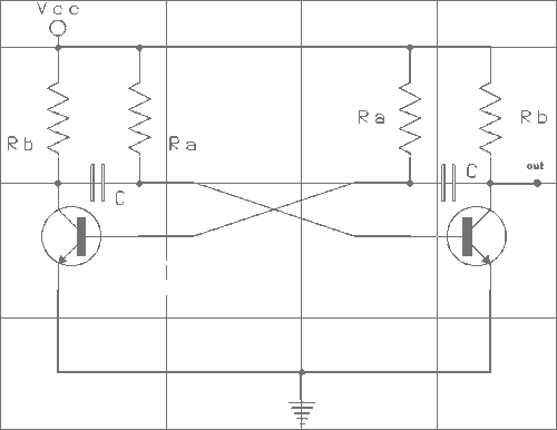

Anyone having a formula to calculate the frequency of the astabil multivibrator in picture? (approximately or preferably exact). Easy to build but analysis is not so straight forward I have discovered.

You must be careful not to use a supply voltage higher than about 5V to 7V for that simple multivibrator. Each coupling cap charges to the supply voltage minus a b-e drop. When a transistor conducts then the charged cap drives the base of the other transistor to a negative voltage almost as much as the capacitor was charged.
Silicon transistors have an absolute max reverse voltage rating for Vb-e of only 5V to 7V because the junction has avalanche breakdown like a zener diode.
Since the junction conducts when you don't want it to, it messes-up calculations for frequency.
Adding a forward-biased diode in series with each emitter to ground fixes it. :lol:
Linear charge
This circuit behaves like an constant current generator charging the capacitors lineary. The slope of charge is determinated by the values and it is easy to make a good calculation for different values on components (Ra and C) based on a plot of the slope (dV/dt) from a oscilloscope. It's more tricky to calculate a universal formula including both Ra and Rb and C together. Naturally there is a limit for resistor values and supply voltage not to damage the transistor.

This circuit behaves like an constant current generator charging the capacitors linearly. The slope of charge is determinated by the values and it is easy to make a good calculation for different values on components (Ra and C) based on a plot of the slope (dV/dt) from a oscilloscope. It's more tricky to calculate a universal formula including both Ra and Rb and C together.
I disagree. The caps charge exponentially by Rb, like any RC circiut. They are discharged with nearly double their voltage across Ra so the curve is a little straighter. It is easy to calculate the charge/discharge times and frequency if the transistor bases aren't allowed to breakdown.

Try RA * C * 2, if both RA's are the same and both Capacitors are equal. This will make the equation for the time it takes the output to go on and off.
In some cases, you will need to multiply the answer by 1/(2* pi). I forget when this happens, but in your case, I dont think it needs to be applied.

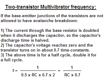

MStechca,
The charged capacitor is driven negative nearly the supply voltage. So it discharges into Ra with about double the expected current.
The capacitor's voltage reaches zero and it begins being charged in reverse by Ra when the transistor turns on in about 0.7 RC time constants. That is for a half cycle, double the time for a full cycle.
