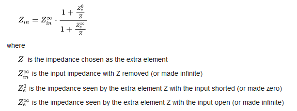

This type of problem can also be solved with the Extra Element Theorem:
https://en.wikipedia.org/wiki/Extra_element_theorem
by inspection:
\[ Z_\infty = 50||70 = 350/12 \]
\[Z_e^\infty = 60||60 = 30 \]
\[Z_e^0 = 20||30 + 40||30 = 204/7 \]
\[Z = \frac{350}{12}\frac{10 + 204/7}{10 + 30} = \frac{685}{24} \]
