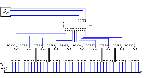

For displaying numbers from microcontroller to a few 7-segment display, many output pins are needed. Is there any device which can converts serial to parallel in 8 bits? So that one output pin control one display.
Yes, a standalone UART (if you can still get them?), but a simpler (and cheaper) solution is to use a microcontroller to do it. But in any case, you generally multiplex such displays, so they use less than you might think (4 seven segment displays only require 11 pins).
It is my idea for reducing the pin count and increasing the 7Segment Display.
If i am wrong then guide me....experts:D
Well I'm not commenting on the exact wiring, and if it would work as shown, but that's a standard method of multiplexing - it has the obvious disadvantage of requiring an extra IC though. You can also use a 4511 LED driver to reduce the pin count to the segments.
