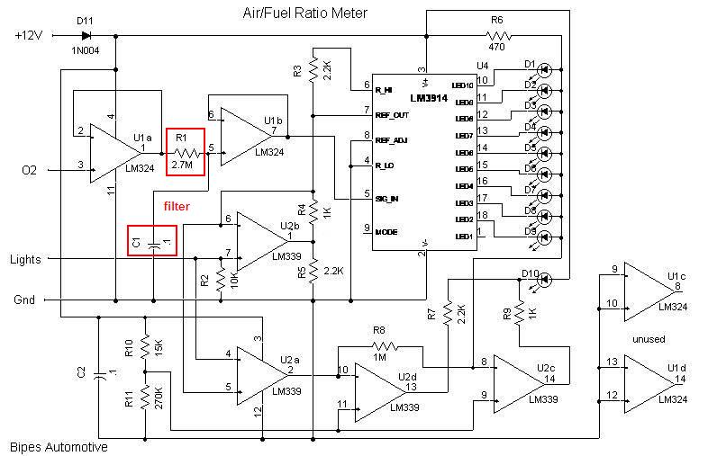

Your circuit lights too many LEDs because it is too simple and doesn't filter the normal voltage fluctuations of the O2 sensor.
Here is a project that has a filter plus lots of other improvements. You don't need the quad opamp and quad comparator if you don't want the other improvements, a filter can be made with a 100k resistor in series from the O2 sensor to pin 5 of the LM3914, then a 1uF capacitor to ground at pin 5.

thank for the hint about o2 fluctuation but the circuit is not on the car right now. I use a variable supply with not much fluctuation , Im trying to do the calibration for 1 led a .58 v and last at .94 but i dont know why the closer i get is .54 to .68 you guys see any bad value in variable resistor? or maybe they not at the right place?..
My trouble is not the sensitive the led in BAR mode go up each 40 or 50mv
the light just keep lite glowing pass that voltage in dot mode and the volts reading on my multimeter change and get .05v up when i switch...
and I have like 14" of wire between the led and the lmcircuit is that maybe too much ? a 10 uf capacator at the V+ of the led maybe do nothing in my case?
