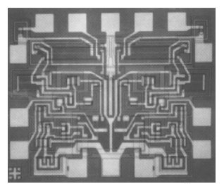

well.... you have the makings of another Bob Pease......:D
the 8-pin dip looks like an LM311 comparator, the 14-pin is likely an LM324, and i agree that the 3rd chip is a TL494......
BTW.... Bob Pease is the engineer who designed the LM311, and is known for both his "hasty sketches" of schematics in his magazine articles, as well as his perfecting the art of "ugly construction", where he builds a circuit as a 3-D puzzle from the ground plane on up... his "ugly construction" technique is good up to and usually beyond 50Mhz....
actually what's more amazing is that he takes that and turns it into this:
