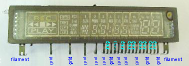

I posted earlier a question about steering a Vacuum Fluorescent Display from my defect dvd player... it seems it gona be difficult but now I found this link https://hem.passagen.se/communication/vfd.html.
But can anyone tell me what to use to control this one
I figured out the filament uses 3.5V
Any help welcome, I'm despered to use this display

If you look at the pic that ive lifted from that page, you can see
that the 7-segment numbers are each covered by a grid, that is to
facilitate the matrix-ing that i mentioned.
These pretty little displays will usually operate on fairly low
voltages, maybe as low as four or five volts.
When experimenting to draw up the grids and the elements, use a
series resistor, these little glowing segments don't need much
current, the grids need hardly any current at all.
So, to sum up, to pick a segment, its grid has to be plus, and
the phosphor element has to be plus, the filament is regarded as
cathode and is taken negative. Sometimes its centre-tapped, that
would probably be for AC use, the c/t being for negative and both
ends balancing with the ac. But these filaments are such low
currents that i would feed it DC anyway.
I hope this has clarified it a little.
