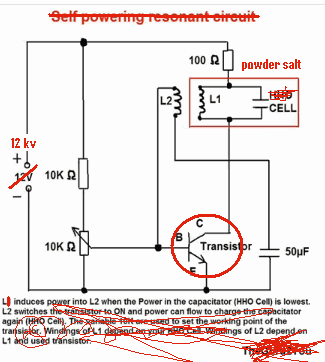

i think it s best to say that i want electrolysis device but i want to break down powder ed salt and achieve that without water or melting the salt, so i want to step up the voltage, to get across the air gaps between the particles, now i know that HV will reduce current and production, so that is where i got the idea to add the "bendini self resonant circuit", since it seems to work more efficiently, and supports a previous hypothesis that i had about the recatance of water but till recently did not know how to project my idea.
having said that though since i need the higher voltage for the air gaps in my salt a transistor is no longer proper for a switching device, which turned me over to the sparkgap, or maybe the flash tube, or anything you think could help

No, putting a load on the output of a Tesla coil will change its operation entirely, and will probably cause it to not oscillate properly. Chances are it won't work at all.
As for the high voltage transistor, what kind of voltage are you hoping to switch? You might be able to use an IGBT or certain MOSFETs, but we'd need a lot more information.
I'm hesitant to help you since you clearly show that you have no idea what you're doing, and you're trying to work with high voltages. I highly recommend AGAINST doing this project until you have more experience with less-dangerous devices.
