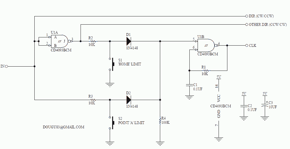

Have a look at the schematic I drew up of a controller, it's only for 1 axis, but the circuit for the other axis is the same. The chip is a 4093 schmitt-trigger input NAND, with 4 gates, so you'll only need 1 chip for both axes. Remember to connect the power (5V) and ground (0V) to pins 14 & 1. Also put a 10uF and a 0.1uF capacitor on the 5V supply to the chip.
The 5V control voltage input is used to set the motor direction, the limit switches (connected to 0V) are used to gate the oscillator (U1B). R1 and C1 control the stepping rate, given by the formula { rate = 0.7 / (R1 * C1) }, which should be about 700 steps/sec with the current values.
You may need to swap the limit switches, or use the inverted direction (shown as 'OTHER DIR' on schematic) if the motors go the wrong way.
good luck!

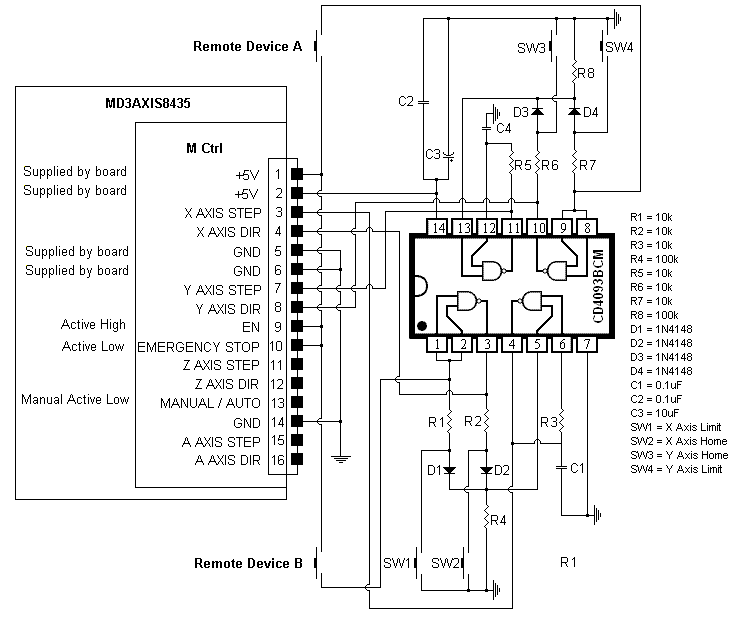

OK... After several revisions, this is what I foresee, based on your schematic.
I'm guessing about pins 9 and 10 of the M Ctrl.
I'm also guessing on pins 5, 6, and 14. GND... should the MD3AXIS8435 and this circuit share GND?
I'm almost ready to run out and buy the parts.
I think I mostly understand the logic.
Thanks for your great idea!
Do you think this will work?

Looks good to me. You have 2 remote device switches; one is going to control the x-axis movement, the other controls y-axis movement. Those switches may be connected together (or just use 1 switch) if you want both axes to move at once.
Also, as the remote device inputs are clean contacts to 5V, you will need a pulldown resistor on the 2 inputs (between 470 - 1k ohm res. to ground).
Yes, the ground should be shared between this circuit and the control port of the card.
I don't think that made much difference. The inputs of the NAND gate are the same.
Also, note that you'll need the aforementioned pulldown resistors on the control input signals.

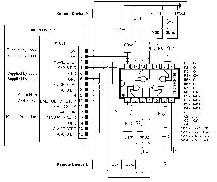

Grabbed all the parts today, and hope to tinker tonight.
I'm not clear on the location of the (1k) pulldowns. At "In" on your schematic?
Also, I couldn't find the CD4093BCM, but for two bucks I got 5 HEF4093BP. Different pinout, but can I use them? The gates have something going on before the inputs, not sure what this means. I can get the others, online, but would like to test in the meantime...
Thanks!
Yes, pulldowns at 'in'. The HEF4093BP has the same pinout as the CD4093BC/BM. Not only the same pinout, but the same function.

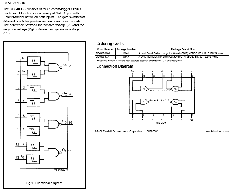

hmmm... the datasheet I have shows a very different pinout for the HEF4093B. It's a bit confusing actually. The pins have 2 numbers... I tried to deduce, but it's still not clear.
I'll attach the comparison.
No the pinout is the same. On the left image, the pin numbers are shown outside the box. Inside the box the input number (I1 to I8) and output number (O1 to O4) is displayed (just ignore these). On the right image, only the pin numbers are displayed. They're the same.
