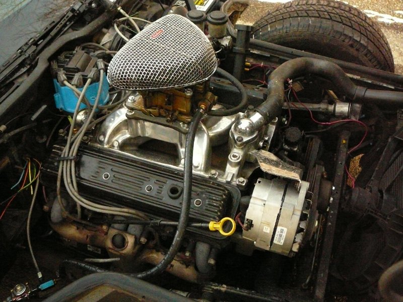

ok, so here is my hack job motor, 100% GM except the intake. It is not pretty but when it warms up I will spend some time making it look nicer, it has been cold.
I know it is not the best looking engine, but I do have a video of how it runs to show that I do know how to build a motor and tune it....
I really hope this let's you know I am for real here.... not that I have a lot of money, but that I allocate the time and have the patience to learn how stuff works and also have the ability to apply it.

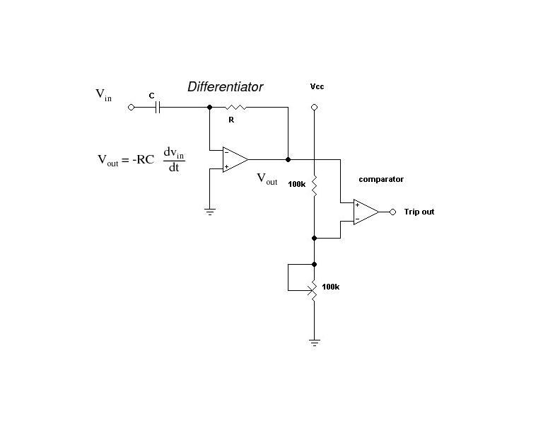

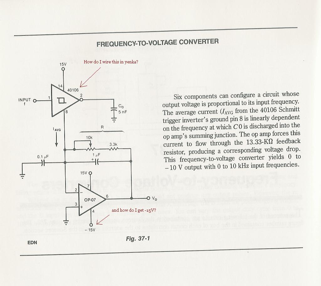

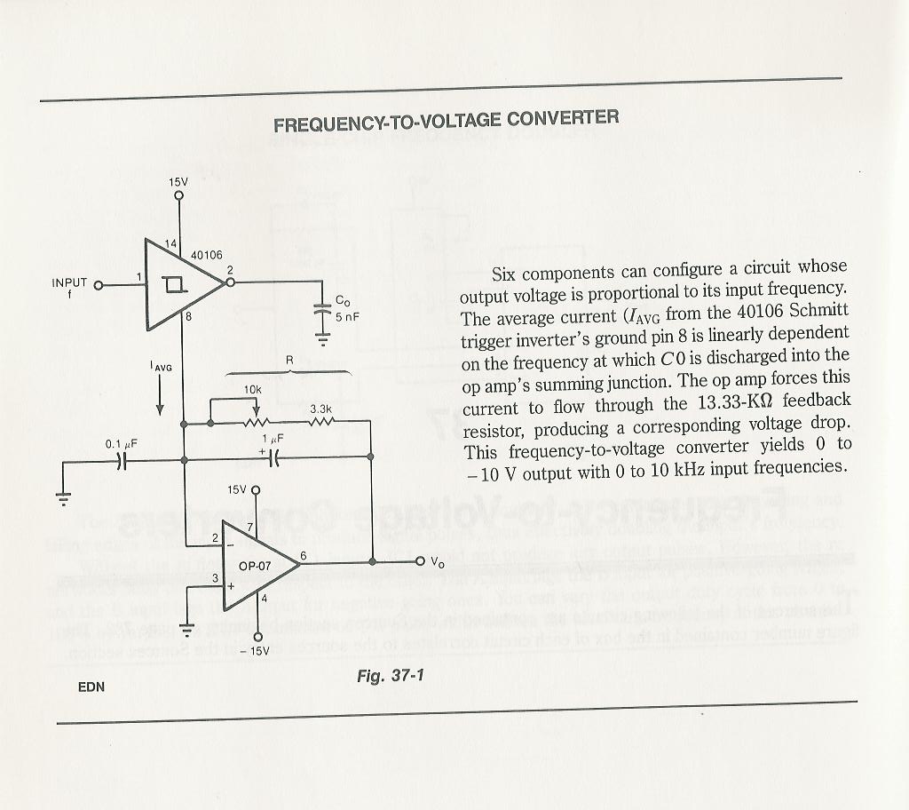

ok i can help you a little bit but not for completion, just check the attched circuits,
the 1st one is a frequency to voltage convertor that has a range of 0-10kHz, and 0- (-10)V out put. you have to modify some components to achive correct scaling for 0-900 rpm. still you can try trial and error.
my advise is to use all 4 firing signals as a signal train to give frequency input then it will be 4 times, it will have some advantages.
2nd circuit is a differenciator and comparator, it will only respond to any change in frequency and give out put. the out put level is proportional to the rate of change of frequency. its gain can be adjusted by slection of R & C on the diagram, the preset will set your trip point.
some one can further help to you to simulate and give correct values. the rest you shoudl try your self

unfortunately I'm already stuck on the very first item :o
in the diagram the first item is a Schmitt 40106 trigger inverter.
I open yenka and that IS listed (wohoo!) .. but it only has one wire in and one wire out.
Then I search google and I find what looks like an integrated circuit with 12 wires?
so now i'm seeing the same IC with 3 different setups?
ok, looking around I find this:
Schmitt Trigger Applications
there it appears to be a device that has 5 wires, but the symbol only has 2, how can that be? This is very confusing stuff here ;p

The differentiator will probably oscillate unless you add a small resistor (e.g., 100 ohms) in series with the capacitor.

how about that 40106 schmitt trigger inverter in yenka, how do I wire it up??
I just installed Yenka, so I know almost nothing about it. Keep this in mind when reading the rest of this post.:)
CD40106 is an IC containing 6 identical Schmitt triggers. The power supply pins are common to all of them. When you place a 40106 on a schematic in Yenka, the power supply pins are not shown, because Yenka only simulates the logic function. The circuit you are trying to simulate uses the 40106 in an unconventional fashion, where power supply currents are an essential part of the sim. There are other ways to simulate the 40106 function (using voltage-controlled switches), but I don't know how to do that in Yenka.

here you want to use ground supply of the smith trigger with op-amp (OP-07) so i sugest you to 1st assemble the frequency to voltage converter. give some frequency input from a function generator or any other mean to scale it down to 0-9000 rpm.
your negetive voltage regulator would gwork fine i hope. for the time you do it with two batteries of 12V or etc.

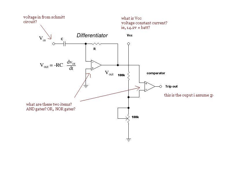

the second part is the diffrenciator and comparator using operational amplifier (not a logic gate), you can use LM324. as you mentioned you have to give the input of the freq-voltage convertor to that and the final output you have to tune to your requirement.
rather than wasting your time on simulations you build and check with real situation, its not a big circuit for you to play around.

the differentiator circuit, according to this: detects a change in voltage and outputs that "change" which I can then run through a diode (or zener diode?) so it only outputs a positive or negative voltage, or even run two diodes and use it to control different things depending on if the engine is accelerating or decelerating :)
The right-hand side of the capacitor is held to a voltage of 0 volts, due to the "virtual ground" effect. Therefore, current "through" the capacitor is solely due to change in the input voltage. A steady input voltage won't cause a current through C, but a changing input voltage will.
I'm liking this, it's new and fascinating to me :)
My only question now is why are there two LM324's being used in the differentiator circuit? I assume? that it is b/c it needs the variable resistor in that circuit to be able to adjust for different input voltages/time making it adjustable?
one op-amp (ie 1/2 X LM324) is used for differenciator, when ever there is a change in frequency it will give a voltage output. but what you are interested is NOT in ALL frequency changes. ie: you have a allowable margin. the second op-amp helps you to set your margin, the preset 100K variable will help you to do this.
for the time use two batteries to get 12, 0, -12 V and check your circuit. ie connect both in series and the middle is the ground point. once your circuit works try for the negetive voltage generator to operate it.
if you will face problem in adjusting the range of the frequency input for the circuit, still you can use it with available range, but you need an iput of 0-10kHz range, for that you can use a megnetic pickup from the engine shaft and make it to be excited by many megnets arranged in the circomference of the shaft flange, it is like you are increasing the resolution of the input.
ex: if you use 10 megnets then your frequency out put will be 9000/60 x10 = 1500 Hz.
