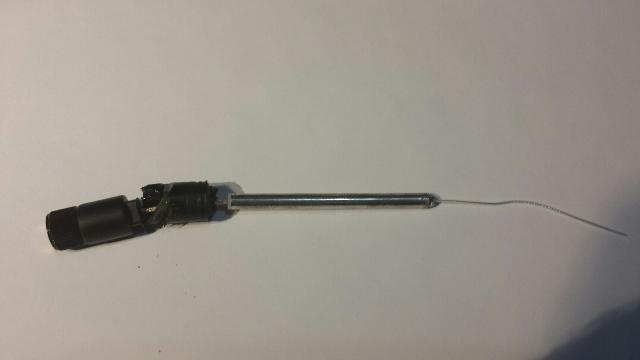

I am taking apart a 900Mhz antenna whip so that it should not be so rigid.
I want to install it in a quadcopter and need to
flex it to install it alongside one of the legs.
The antenna (picture attached) consists of:
outer plastic tube
braided shield
inner plastic tube
center conductor
They have soldered the shield to a hollow rigid metal tube. I want to know if I can remove this metal tube, and have just a shield.
Since it is not connected to the center conductor it should not affect SWR, or is the larger amount of metal
acting as a ground plane of sorts, and I cannot remove it?
Thanks for your help.
No, you cannot.
Oh yes it will!
That form of antenna is known as a sleeved dipole.
The metal tube is effectively one of the legs of the dipole folded back around the sheath of the coax.

Ok, so if instead of the tube, I peel back the sheath on itself to an exact equivalent length of the center conductor protrusion, I will have the exact same thing, and it will be flexible?

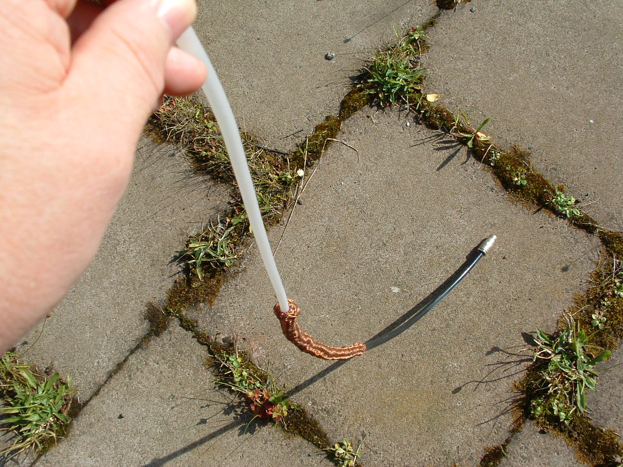

A few years ago I did some half hearted experiments in making a sleeved dipole at a much lower frequency (145MHz) and was not impressed with the results as measured using a fairly sophisticated antenna analyser and just gave up without trying it with a real transmitter/receiver (It was a half hearted experiment after all!).
What I did to make this sleeved dipole was roll the screen braid back over the outer plastic sheath of the coax cable, effectively creating other element of the dipole by exposing the center conductor.
You could try something like this, but it would probably be quite difficult with thin coax.
Alternatively, why not try removing the solid tube and replacing it with several thin wires of the same length?
I suggest that you try it with four wires.
Simple cheap and flexible.

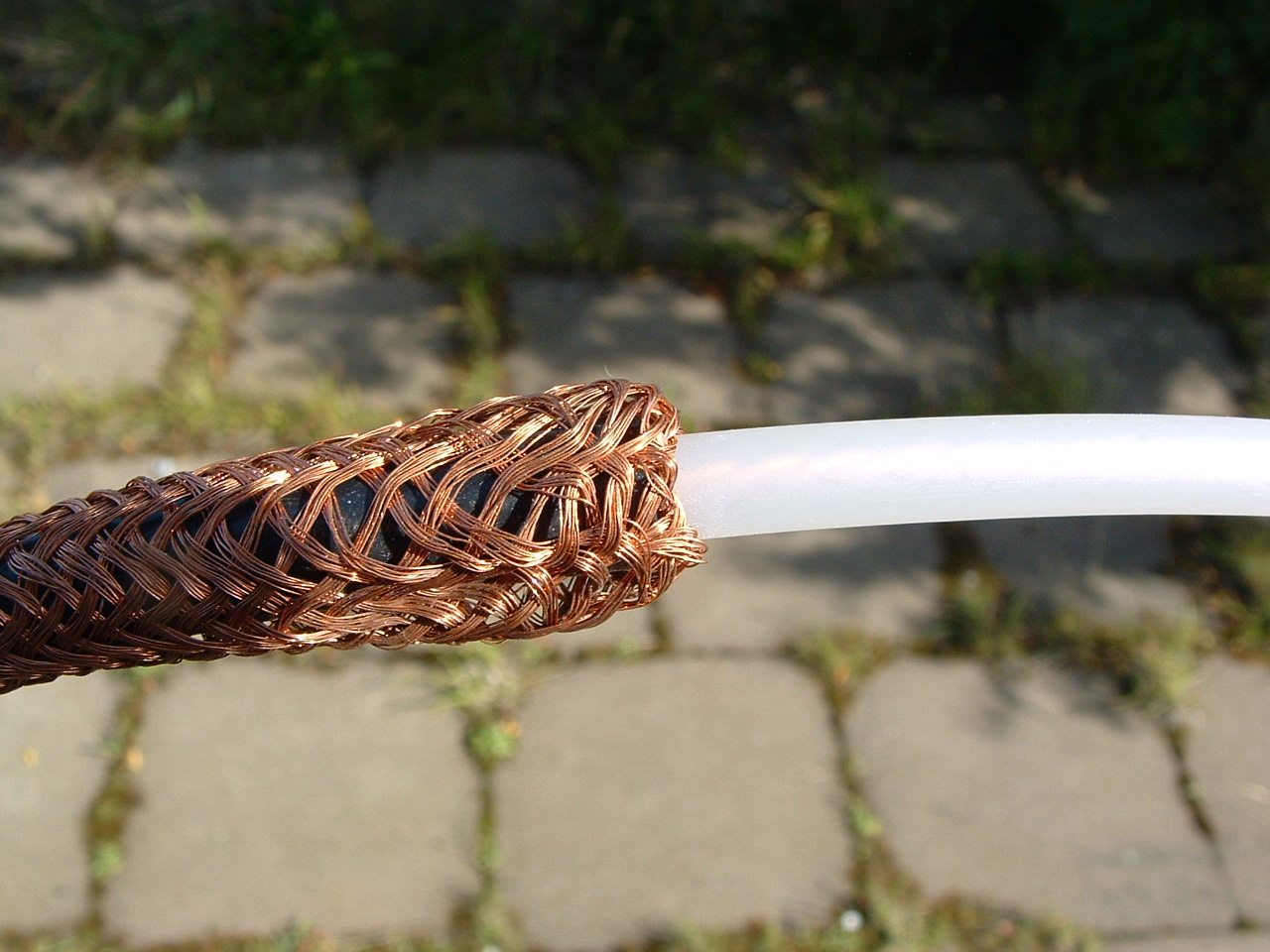

Pictures of my half hearted sleeved dipole rescued from the junk pile.
