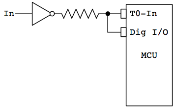

I'm using the method described in Microchip appnote AN592. A digital I/O pin is connected to the Tmr0 input pin. Setting the digital pin to input (Hi-Z) enables the timer, and and setting it to an output disables it. Toggling the I/O pin while in output mode flushes the prescaler into the Tmr0 register, in order to determine it's value.

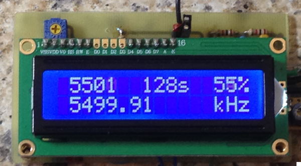

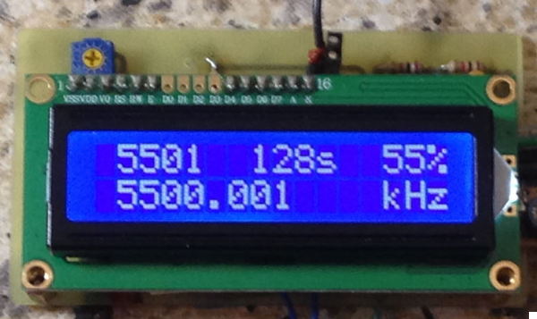

Here is the working counter.
The top line shows, from left to right, the 1ms count, the number of averaged samples in the running average buffer (described below), and the input signal duty cycle. The bottom line shows the 1 second count. The way it's set up, it starts out in 1 ms sample mode and displays an averaged value on the bottom line starting with 16 samples, then 32, 64 and finally 128 samples. Once it gets 128 continuous samples at constant input frequency it automatically switches to 1 second sampling and displays the one second count on the bottom line. It also does 1 ms samples between each 1 s sample to update the top count and detect frequency changes. This seems to work well at responding quickly to frequency changes, but giving maximum resolution when the frequency is stable.
Here is the counter in 1 ms averaging mode:
In this mode, only two decimal places are displayed. Even with 128 samples at 1 ms, the last digit tends to vary by ±2 counts.
Ah... Ok... You can do the same thing with just the RA2 (T0CKI) pin. That is, make it an 'input' for gate "on", make it an 'output' for gate "off", and clock it to flush and capture the prescaler value. Whether you're using one pin or two pins, the important thing to note is that you have a way to turn the gate "off" in a single cycle during that left over instruction cycle when we fall out of the gate timing loop.

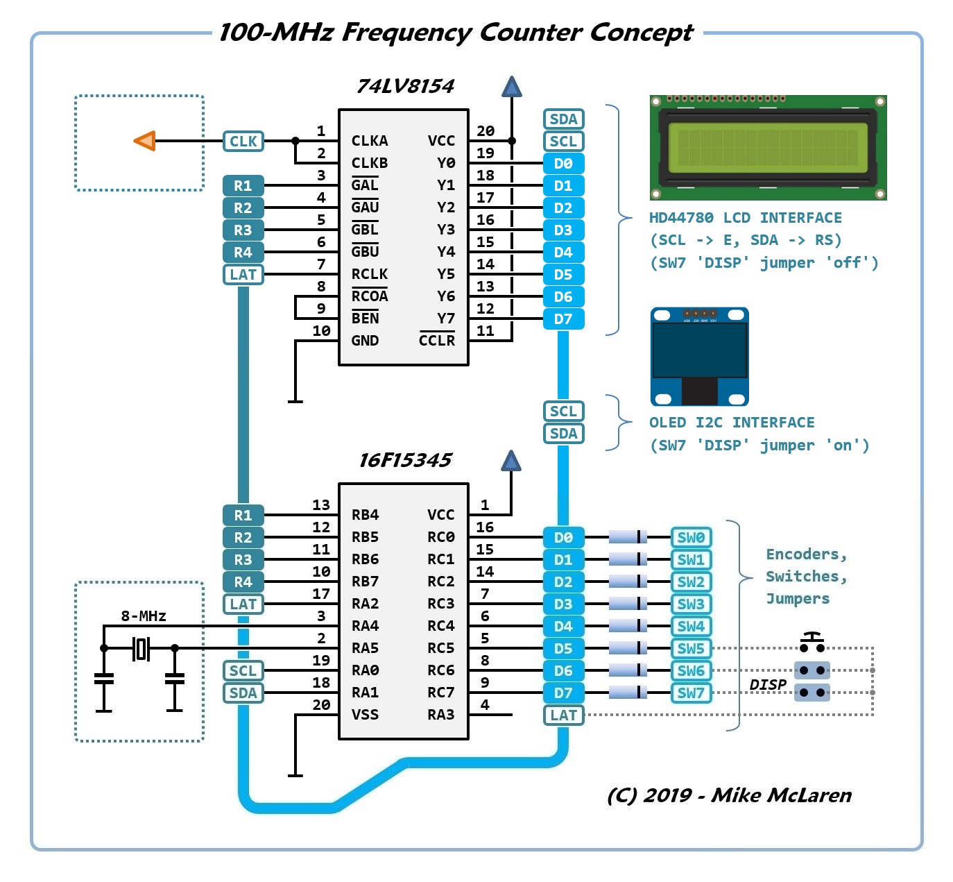

Here's a quick-n'-dirty concept drawing;
In fact, I had been thinking ahead to a future frequency counter project that could go above the 50 MHz limit of the PIC's Timer_0. I figured, why stop at 100 MHz
Just use an ESP32 module - program with an arduino IDE. It runs at 240MHz, counts microseconds for you and you can easily output to a nice I2C or SPI OLED display.
