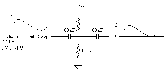

Is that what you mean? It looks okay in LTSpice.
How about the -ve offset? I need to shift back to the original position at the other end of the output. Same method and the supply voltage inverted?

THe capacitor needs to be much larger (hundreds of microfarads perhaps, 100uF, 200uF, or 470uF would probably work) and you want only the left capacitor, not the right one. THe right capacitor would just remove the DC offset that you just added (in the same way the left capacitor stops the DC from feeding back into the audio source).
I would also think you could increase the resistors (maybe by a factor of two) to reduce the load the audio source has to drive.
As dknguyen mentioned, the cap may have to be larger. It depends on how low of a frequency you want to couple. Notice how I placed the DC offset into the PIC at 2.5V. This will allow you to take advantage of the full dynamic range of the ADC and avoid clipping if the input waveform goes above 2Vpk-pk:

Yes, I got it. With my original circuit, the output is the same as input. What I want is before the output coupling cap.

If the signal frequency is as low as 20 Hz, the the capacitor value will be..? How much reactance should the capacitor be?
The output is down -3dB (half power) when the reactance of the capacitor is equal to its load resistance. So your 0.1uF capacitor feeding 1k and 4k resistors has a -3dB frequency of 2kHz. Like a tweeter.
The 0.1uF capacitor feeding two 10k resistors has a -3dB frequency of 320hz. No bass.
You also must look at the input impedance of the ADC which is in parallel with the two resistors.
Just quick read the datasheet of the PIC under electrical characteristics. The recommended input impedance of ADC is 2.5 k:eek:hm:
So I can use 3.3 uF capacitor to feed two 5 k:eek:hm: resistors to allow the signal as low as 20 Hz at -3 dB and above?
Another question, with the load of 8:eek:hm: (speaker), to allow 20 Hz of low frequency, 1000 uF coupling capacitor is needed right? That is usually electrolytic type, how about the connection polarity?
