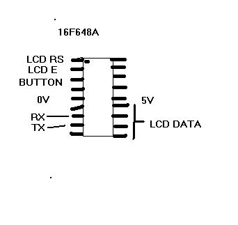

I'm trying to get the RX and Tx to work on a 16F648A PIC with an LCD. The LCD data pins are connected to PORTB high byte. The RX is working ok, but the when the TX outputs it's signal, the voltage is 0 to app 1V swing. I've tried switching TX on and off but this has the same result. So can the Tx be used when an LCD is connected this way?

You can connect any output pins to an LCD (you don't need input ones, unless you're reading the busy signal, but it's simpler to use delays instead, and saves an I/O pin).
However, I'm not really very clear what you're doing, or how you have everything connected - but the most common problem is not disabling unused hardware (such as the comparators or analogue inputs).
Incidentally, I tend now to connect the LCD to PortA as most of the hardware I'm using uses PortB.

Here's a JPG on the pinouts. The Data lines are connected to PORTB H and the TX and RX are connected to PORTB L The LCD is working fine, the BUTTON and RX are ok, but the TX shows an output, but it it only 0V to 1V swing. I've tried pullups switching ,but it is stuck on 1V max.
It is for a portable GPS NMEA output.

Is the Tx pin output to or input from gps ?
Is the data direction register set correctly ?
If receiving works, is Tx needed ?
Have you the code... I'll see if I can get it working for you...

Assuming that you changed those lines, then the problem is at this end. Do the RB2 and RB3 lines go ON/OFF (to 5V) at the start also, as the program dictates?
EDIT: I have just tried a PORTB ON PORTB OFF routine at the beginning of the program and all of PORTB switch 5v-0V then once the program starts it reverts to 1V-0V at TX
C.
Sounds like a large current draw on the tx pin..

How did you measure the voltage?
With oscilloscope or digital voltmeter?
The voltmeter shows some average voltage between
0 and 5V when tx is transmitting.
Hi Both,
I used a voltmeter and an oscilloscope, RX 0 to 3.5V TX 0 to 1V.
I tried 4x PICs. And tried the previously mentioned PORTB =1 which showed 5V.
