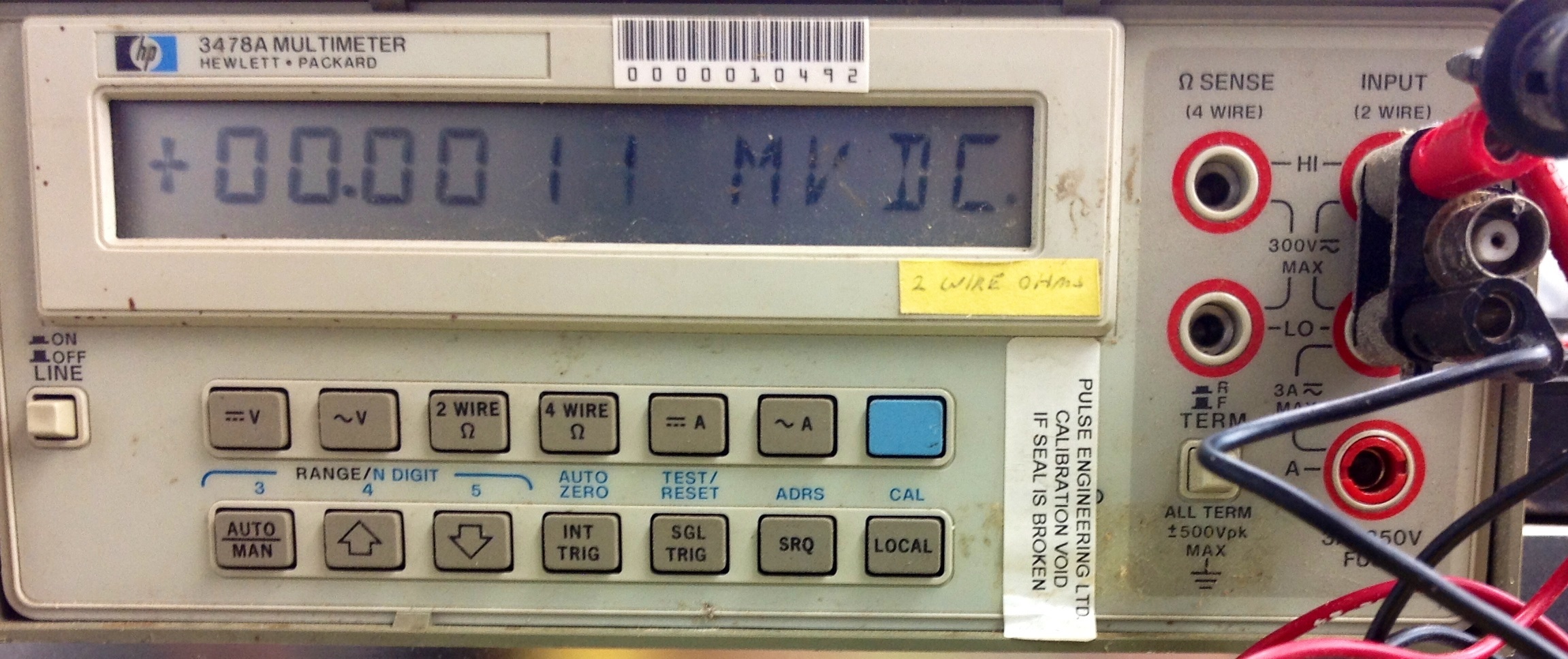

throbscottle, Here is a Picture of it, Also sent to you in an Email.
I have many meters from $8 3 digit types with transistor test sockets, Fluke 96, 5 digit RLC meters, counters
But if I want to measure V,I,R in avg or RMS To 6 digits resolution with zero Cal I use my old HP meter.
10 uΩ to 100MΩ 2 or wire ..you might check used online Ebay.

And so I look for hp bench meter on eBay, and there it is!
Thanks for the tip, Tony :)
