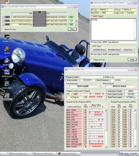

Ok I edited the code inserting code from the analog tutorial, and piclist.com. The program transmits the Thou, Hund, Tens, Ones and a newline character, BUT what it transmits is wrong. For a og reading it sends 'maa newline with the 'maa' part changing with the acceleration. The strange thing is that it simulates perfectly in PIC Simulator IDE. Below is a picture of the result. I can't figure this one out. Right now I feel like sebi's avatar. Sorry about the size of the picture. Its hard to see but the software usart shows 0238 and the analog pin input is 238 Thanks in advance for your help

Oh right :lol: I thought by protocol you meant the ANSI or TTY or MINITEL etc. settings. My serial settings are correct. I have isolated the problem more. It seems that when the PIC is supposed transmit a hex 30(decimal 0) it transmits a hex 60(character '). If it should be a hex 31(decimal 1) it transmits a hex 61(character a). I can't make sense of it. Since the program simulates perfectly and I get the same result no matter which serial port logging program I use( even a very basic one that just reads whatever is on the port) It must be the serial routines in my program, which I am going to replace with one that is known to work.
Eureka!!!!!!!!!!! :D At last some sucess. I used a different serial routine by Tony Nixon. AND programed a different new chip, and it worked. It did not work with the original chip even when using the new serial routine. But the new chip works good!! I'm still getting stray characters like before. Could this be a result of using the internal oscillator. I did not set oscal as I accidentally erased the oscal data. (duh)

The internal oscillators work fine at 9600 baud, I use them all the time. However, using the internal oscillator at the wrong frequency is VERY likely to give problems! - you MUST restore the OSCAL value if you want to use the internal oscillator.
