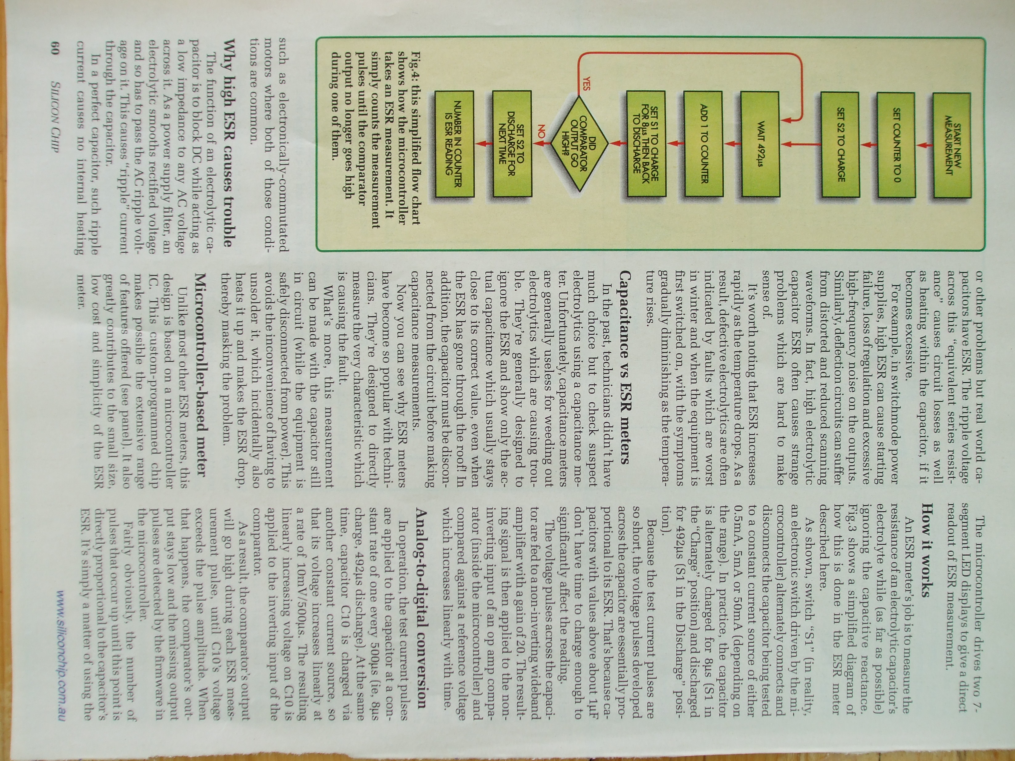

This is what I use & wouldnt be with out it & been using it for several years now. Its still avalable as a kit from Altronics. ESR Capacitor Test Meter Kit (MK11) $89.95. K2574. www.altronics.com.au

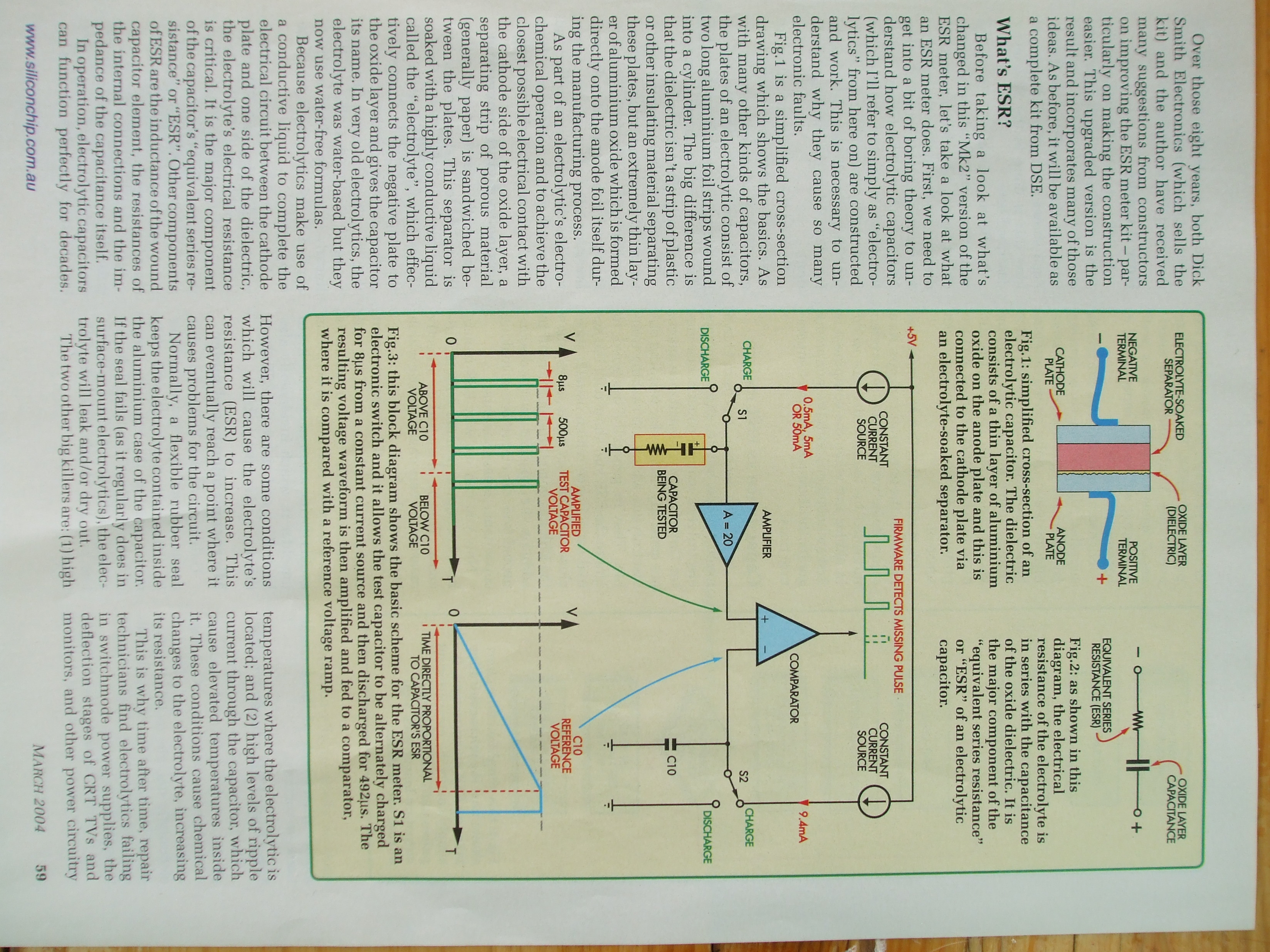

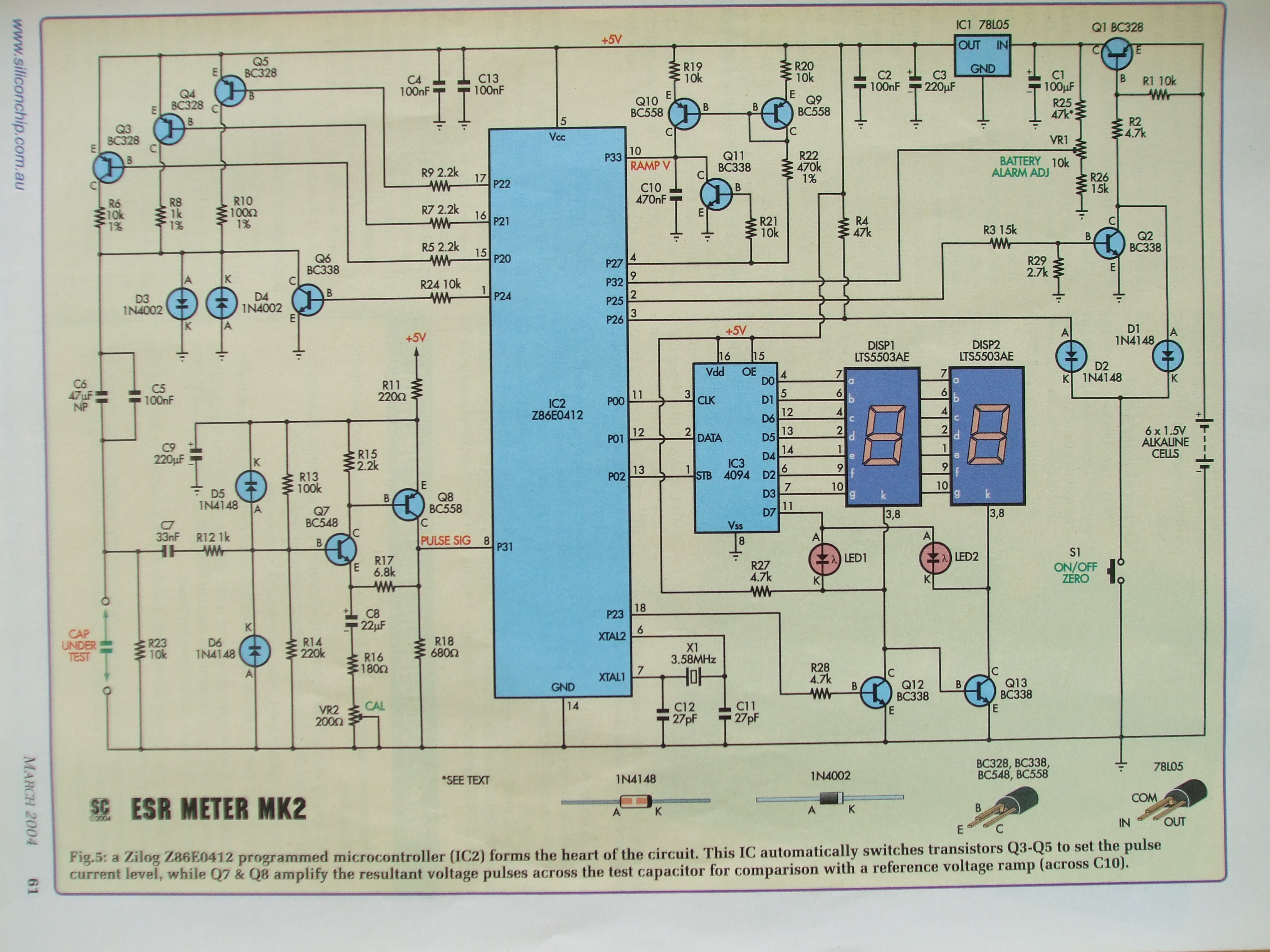

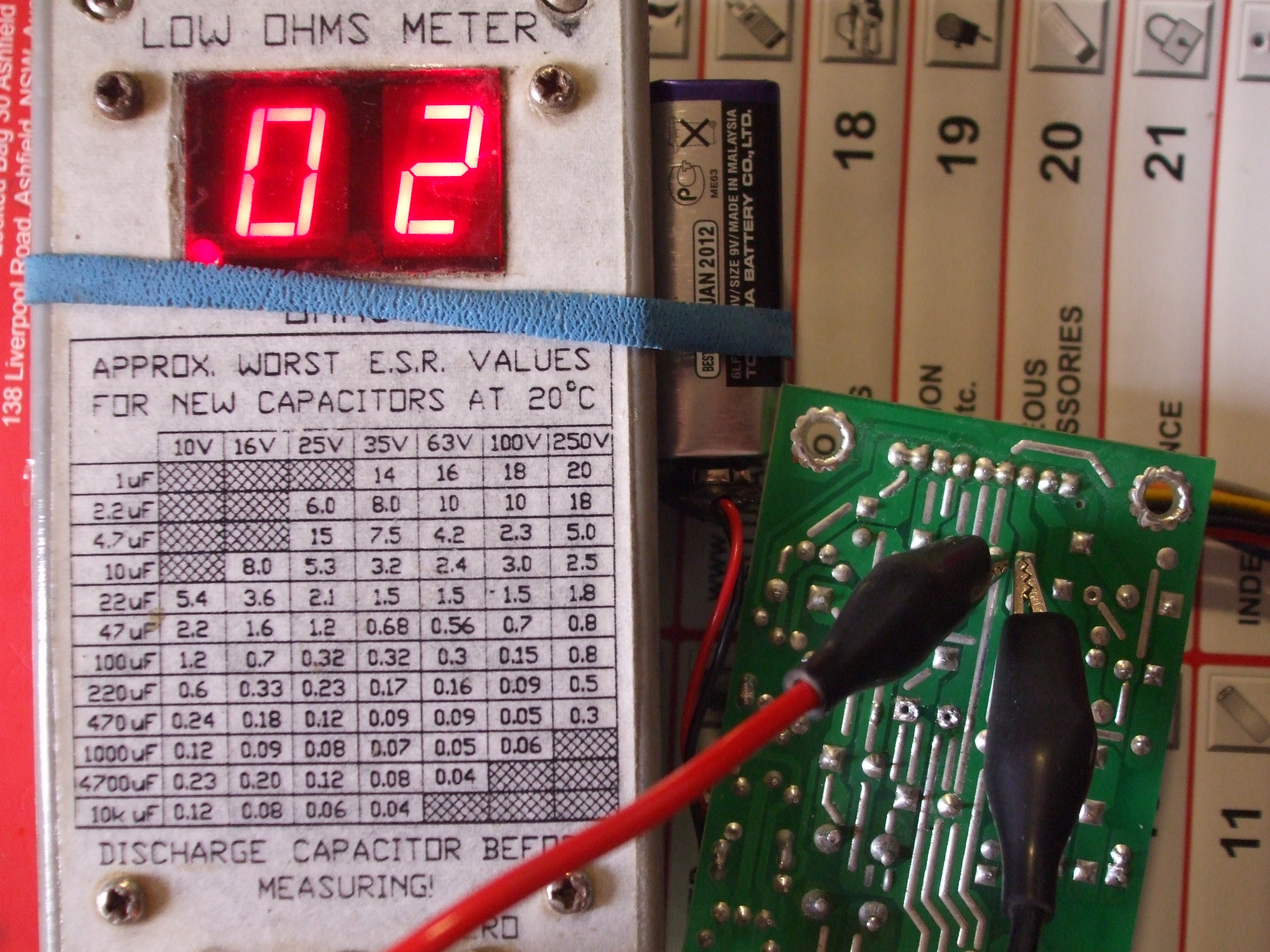

Heres a bit more info on it, Ive built & use 2 of these units. Mk1 & Mk2.

Ill second that ESR meter the Debe uses, I have 2 of them that have provided many years of good service. They also measure low ohms, like resistors and wires down to 0.01 ohms.
Thye are a little heavy on 9v battery use so it's worth putting a DC jack on the side enabling you to use a 9v DC wall-wart (plugpack).

The kit debe linked to at $90 is ideal for testing caps in circuit. It uses a high freq test waveform of very low voltage so it does not activate any diode or transistor junctions in the board under test. It is a well proven design.

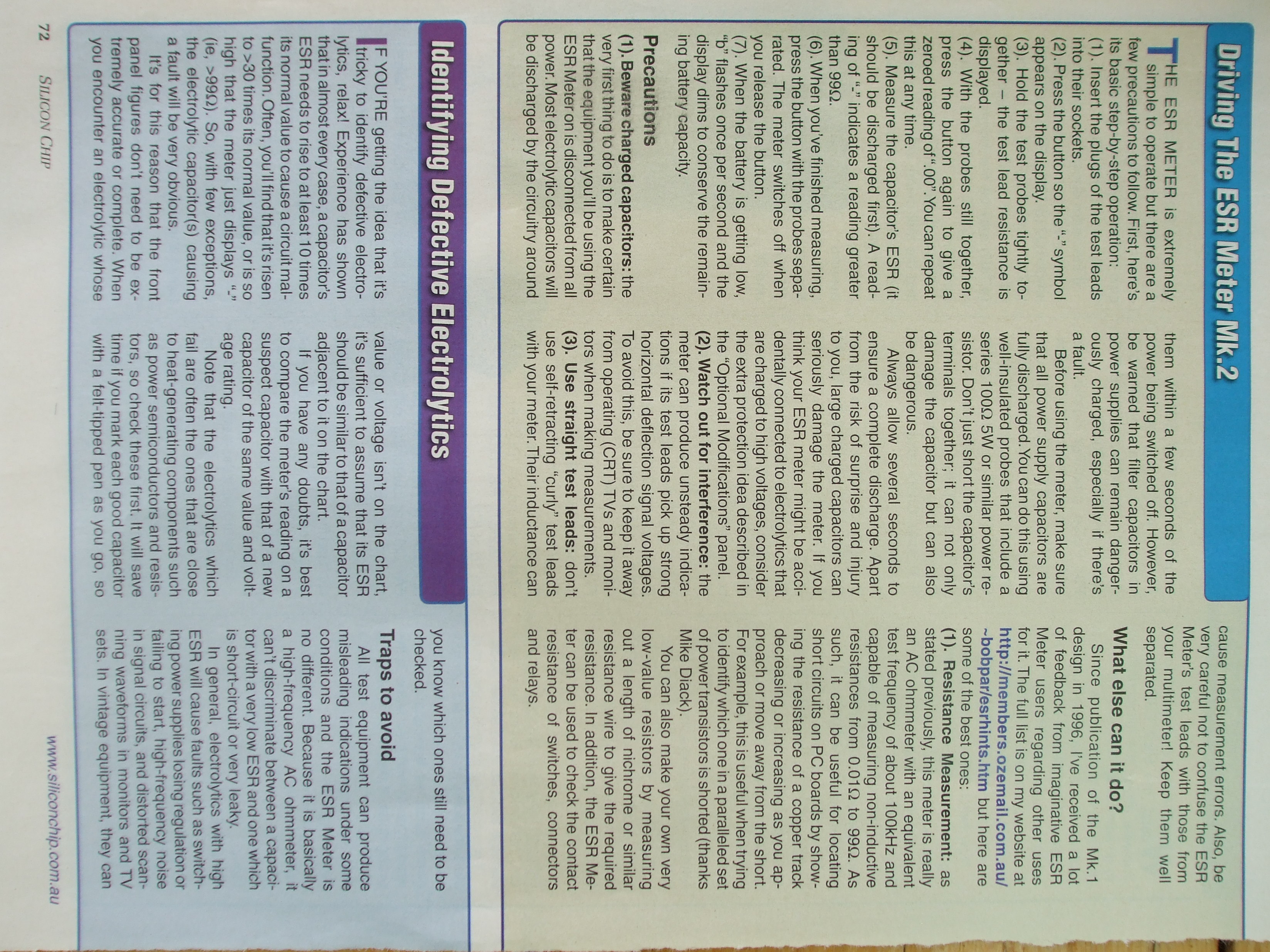

Bit more info, would post more but theres 15 pages.
