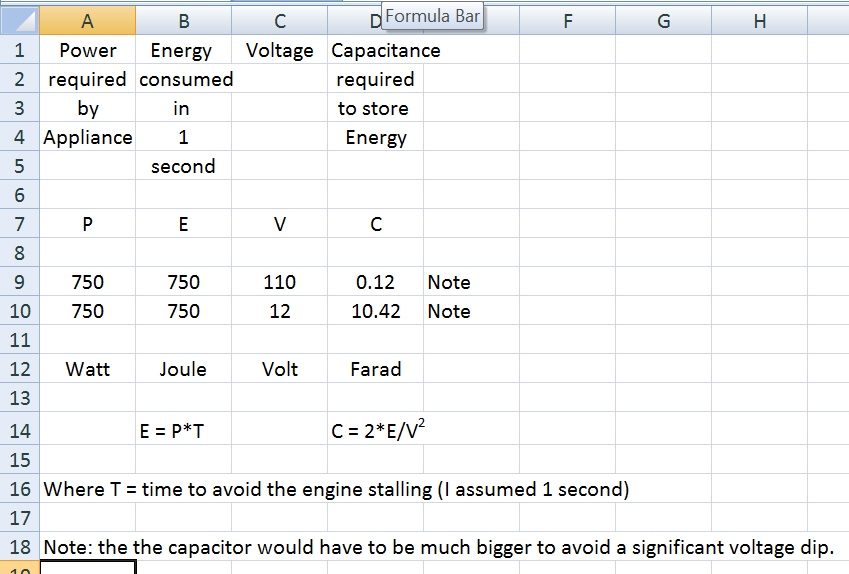

Morning All! I have a home made generator unit based around a 5 1/2 HP briggs engine and 63 amp delco alternator. This system is both setup to supply 12 Volts for charging batteries and is setup to supply 100 Volts DC. I have been experiencing problems with engine stalling with heavy loads and have been looking into the possibility or not of using a cap of suitable size effectively with the alternator? In my quest to find the answers to my question I came across the website known as the "Backshed" the site is dedicated to alternative energy and windpower. I started this topic where I caught the attention of Len who is a electronics engineer by trade. In the process of coming up with the calculations for a suitable cap Len asked that I post the below chart so someone can confirm his calculations as being accurate regarding the size of the cap needed? This is the original discussion on the backshed https://www.thebackshed.com/forum/forum_posts.asp?TID=4448&PN=1

Hey all! I thought I had uploaded the follow attachment? Did not take for some reason or another.

If you are running a common Delco alternator in a modified setup to get a higher than stock voltage out of it you can also expect it will take a higher than stock input power to drive it at peak loads as well.
Assuming your 5.5 Hp engine is up to snuff its should be able to support around 4100 watts mechanical output peak before it starts dropping off. At 100 volts that would be around 41 amps but most automotive alternators are around 50 - 80% efficient in their normal working range so realistically I would be hesitant to expect much over 20 - 25 amps at 100 volts before you simply run out of engine power.
As far as capacitors go at those power levels they are completely impractical or outragiously expensive for anything more than multi millisecond pulses so a good old fashioned battery bank is the only practical way you will be able get the necessary reserve power for any extended overload period.

A capacitor will do nothing. Three phase full wave rectifier output is used to minimize ripple.
