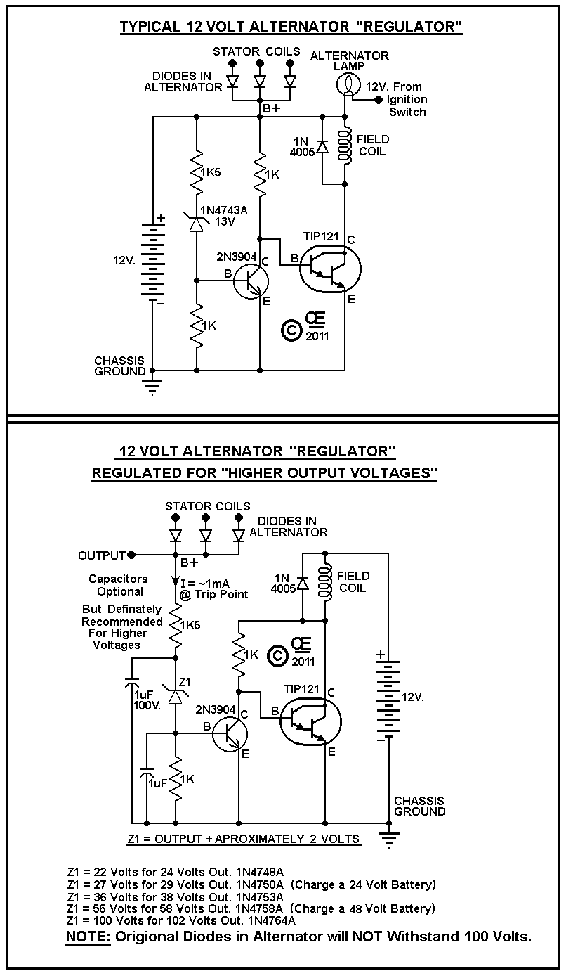

One possibility is to use the stock regulator but power it from the external power source and use a simple resistor voltage divider network to drop the sensing input voltage down to a usable 12 volt level from the 100+ VDC output.
On the Delco SI series alternators there is a internal power feed from three phases to the regulator. It looks like a single block of plastic with three leads going to the three phase connection of the rectifiers and the fourth lead going to one stud on the regulator.
If you remove that it will allow an external 12 - 15 volt source to feed the rotor power through the F lead on the regulator wiring harness and the second S lead to work as a remote voltage sensing input point.
By putting a proper resistor divider on that input you can recalibrate the regulator to work with a different output voltage range.
The attachment shows a similar arrangement, but it uses a resistive divider & a Zener diode.
The problem with a simple resistive divider is that it attenuates both the voltage & the voltage change.
Thus the changes seen by the Regulator (assuming a 100 Volt output from the alternator) are about 1/10th of the actual change that occurs at the 100 Volt end.
But by using a Zener, the Zener provides the off set for the voltage, but its dynamic resistance is low, so the voltage changes are not attenuated.
Note that - there is a drafting error in the lower diagram since the 1k resistor goes to the bottom of the coil, not the top as in the upper diagram.
