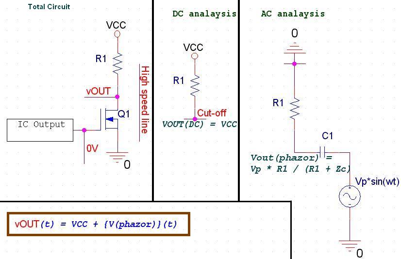

Capacitive coupling due to parasitic capacitance.
alphacat
Hey,
I split the "Total Circuit" into
- Dc circuit
- Ac circuit
And then I wrote the final vOUT of the total circuit:
vOUT(t) = VCC + {V(phazor)}(t)
Is this analysis correct please?
untitled-jpg.35315
