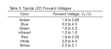

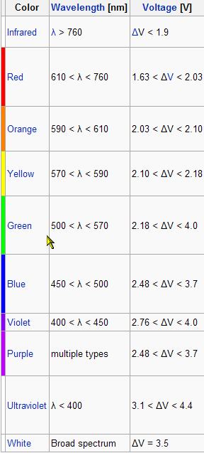

But the main Problem is
i am confused about the voltage and current requirement for the led so
plz give me some information about the voltage and the current ratings of some different led's
and some math to calculate resistance
i am waiting for reply
once again thanx

Look at these images, the current depends upon the LED type, which type do you have.?
Airian generally you don't calculate a resistance for a diode, because it changes dynamically with the voltage/current going through it and it's temperature, though you can make observations.
A simple example is a common white LED might be rated at 3.6 volts forward @ 20mas of current, which works out to being the same as a 180 ohm resistor. A diode is not linear though, say for example you increase the voltage to 3.7 volts you would expect a 180 ohm resistor to only increase it's current from 20ma to 20.56ma where as an LED could increase to 25ma or more. Experimentation and observation will teach you better than a data sheet or personal testimonies will.
