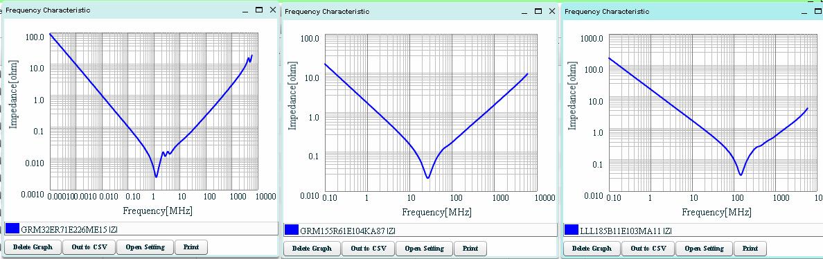

Attached is a graph of 3 capacitors. (ceramic) It shows how capacitors resonate and become inductive at high frequencies.
22uf, 0.1uf and 0.01uf.
I have a bank of 330uF high current, low ERS, low ESL capacitors. (the best money can get) They resonate at about 200 to 300khz. I am slamming them with 320khz square wave current. At 1mhz the caps are not much good. They do not filter out 10mhz and above because they are to inductive. I have 2 of the 22uf ceramics, 2 of the 0.1 and some 0.01uf caps all in parallel. The smaller caps work well at high frequencys.
